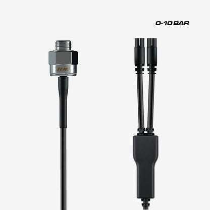

Combined Temperature & Pressure Sensor
Maximise your data without crowding your chassis with a high-performance 0-10 Bar Combined Temperature & Pressure Sensor, designed specifically to sample two critical measurements through a single port.
By integrating both data points into one robust unit, you save weight, reduce plumbing complexity, and simplify your wiring harness, all while maintaining the precision required for elite motorsport. Whether you are monitoring engine oil, coolant, or fuel systems, Aim Combined Sensors provide the real time accuracy needed to protect your hardware and shave seconds off your lap times.

The Combined Sensor utilises two distinct internal sensing elements, housed within a single threaded body. This allows it to tap into a single fluid gallery, such as an oil sandwich plate or a coolant bypass, to provide two independent signals.

  • Temperature Sensor: PT100 thermo-resistor with 2kOhm pull up internal 5V ref
  • Compensated Temperature Range: From –10°C to 125°C
  • Temperature Working Range: From –20° to 135°
  • Accuracy: < ± 0.5% FS (CLNH – combined non-linearity and hysteresis)
  • Overrange Pressure: 1.5 x rated pressure
  • Burst Pressure: 3 x rated pressure
  • Waterproof: IP66
Mechanics Characteristics
  • Housing Material: AISI 316 stainless steel
  • Cable Length: 500mm
  • Tightening Torque: 20Nm
Electrical Characteristics
  • Supply: 8-16V dc
  • Pressure Sensor Output Signal: 500mV (0 Bar/PSI) – 4.500mV (Full scale)
  • Temperature Sensor Output signal: Standard PT-100 with 2kOhm pull up internal 5V ref
