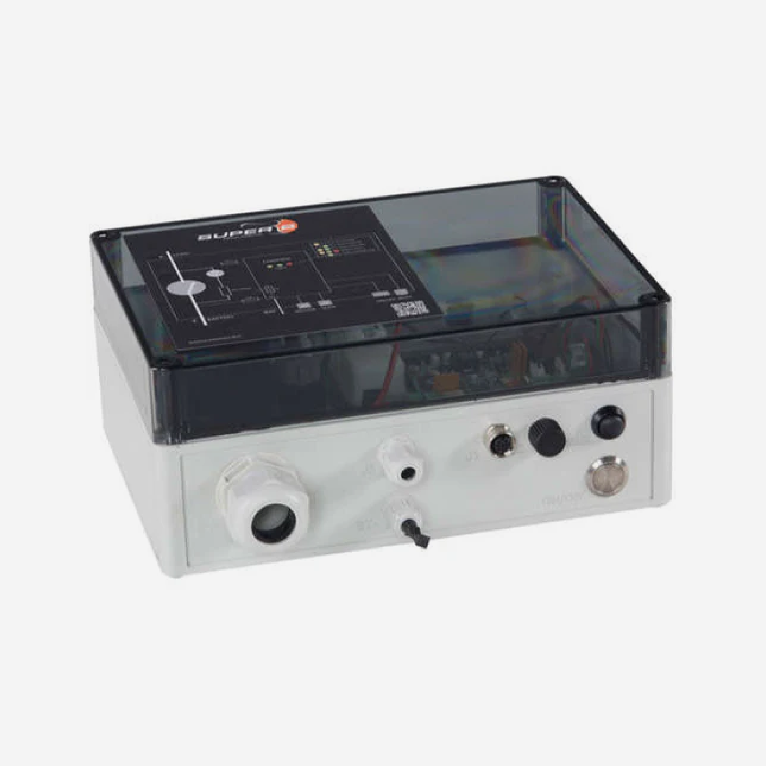

    A BIB manages and protects lithium-ion battery banks in various applications, serving as an interface between the battery bank and the load or charger, ensuring safe operation and optimal performance
    superb lithium batteries
    What Is A Battery Interface Box?
    The Super B Battery Interface Box (BIB) is a device capable of connecting and disconnecting a battery or a battery bank to a load/charger (DC bus) to protect the Li-ion battery or battery bank against improper use. The BIB communicates with the Battery Management System (BMS), ensuring safe operation and optimal performance.
    The Battery Interface Box can be used in various applications, including off-grid, marine & industrial power supply and (renewable) energy storage. The BIB may not be used in medical and aviation-related applications.
    Product Features
    The auto-on functionality allows the BIB to automatically connect the battery bank to the DC bus when certain conditions are met, such as the absence of alarms and sufficient state of charge (SoC)
    The BIB includes several safety features, such as automatic disconnection in case of missing batteries, pre-charge circuits to prevent inrush currents and programmable SoC thresholds to prevent deep discharge
    The BIB uses the CAN open protocol to communicate with batteries and other system components, allowing for integration into complex systems
    Up to 16 batteries can be connected to the BIB without external CAN power. With the 12V BIB versions, external CAN power is always necessary
    Collects the information from all Li-ion batteries in the battery bank, presenting it as one battery
    The BIB is a standalone device, managing the connection and disconnection of the battery bank based on predefined conditions and battery statuses
    Programmable power down on user-adjustable battery (bank) SoC level
    Real time clock for accurate time-stamped function, statistics and error logging
    Up to 100 Li-ion batteries can be connected to the BIB with the use of external CAN power
    The BIB can be configured using a CAN-USB converter and the battery monitor software
    Super B Battery Interface Box For Nomia & Nomada
    Battery Interface Box Compatibility
    The BIB is compatible with various Super B batteries, including the Nomia 12V210Ah and the Nomada 12V105Ah, as well as various cables and accessories. For more information on which products the BIB is compatible with, take a look at the user manual.
    The Super B Battery Interface Box is available in various variants to suit your needs: 12V350A, 24V350A, 48V350A, 12V600A, 24V600A and 48V600A.

    PRODUCT SPECIFICATIONS
    Dimensions (LxWxH)
    180 x 254 x 111 mm / 7.08” x 10” x 4.37”
    Case material
    PC
    Ingress protection
    IP 54
    Certifications
    CE
    Supply voltage
    7.5 V - 16 V (SB BIB LV12V350-600A) | 7.5 V - 32 V (SB BIB LV24V350A-600A) | 15 V - 64 V (SB BIB LV48V350A-600A)
    Rated current
    350A or 600A
    Precharge resistor value
    1 ohm (SB BIB LV12V350-600A) | 4 ohm (SB BIB LV24V350A-600A) | 16 ohm (SB BIB LV48V350A-600A)
    Voltage difference across main relay to turn-on
    1.25 V (SB BIB LV12V350-600A) | 2.5 V (SB BIB LV24V350A-600A) | 5 V (SB BIB LV48V350A-600A)
    Consumption in OFF-state
    100 mA
    Consumption on standby
    330 mA (SB BIB LV12V350) | 197 mA (SB BIB LV24V350A) | 142 mA (SB BIB LV48V350A) | 740 mA (SB BIB LV12V600A) | 420 mA (SB BIB LV24V600A) | 260 mA (SB BIB LV48V600A)
    Recommended operating Temp
    -20°C to 45°C / -4°F to 113°F
    Recommended storage temperature
    -10°C to 20°C / 14°F to 68°F
    Relative humidity
    10-90%
