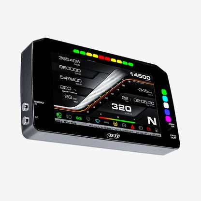

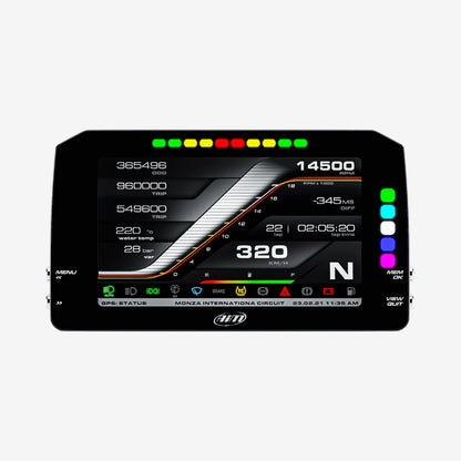

The MXP car dash display logger has a 6" TFT digital display, which has been designed to acquire and display data coming from the ECU. It is an ideal choice for racers who want valuable data at their fingertips but might be limited by space in the cockpit.

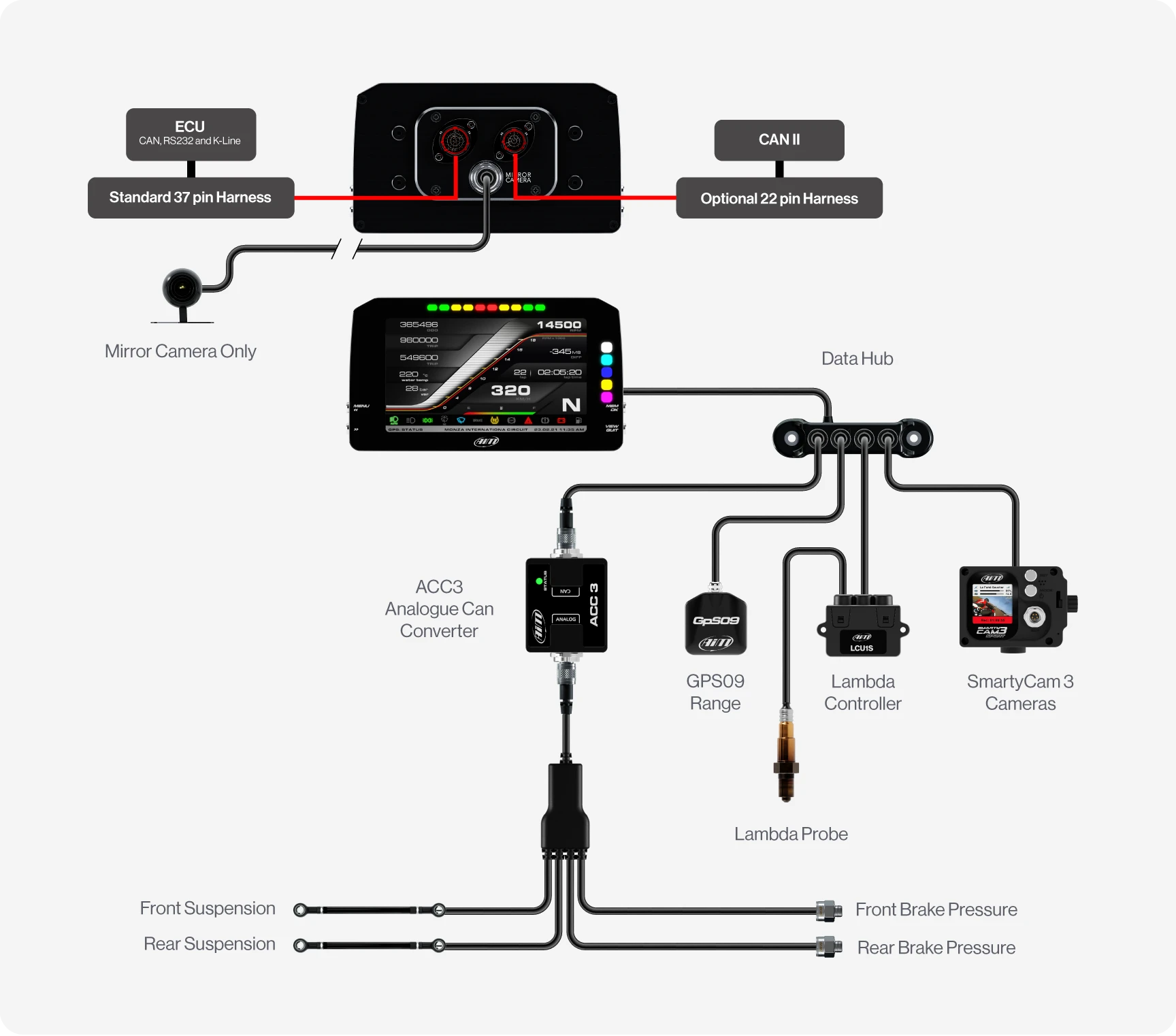

Connecting the MXP 1.3 dash to your car's ECU is simple. You can sample dozens of channels straight from the ECU. This is usually the quickest and easiest setup, needing only a cable connection to the ECU instead of multiple connections and analogue sensors.
The sampled data will depend on your actual ECU, but typically includes RPM, engine load, throttle position (TPS), oil, air, water temperature, oil pressure, battery voltage, speed, gear and lambda value (air/fuel ratio). The list of available ECU drivers is constantly updated and upgraded, and includes over 1,000 different ECUs.

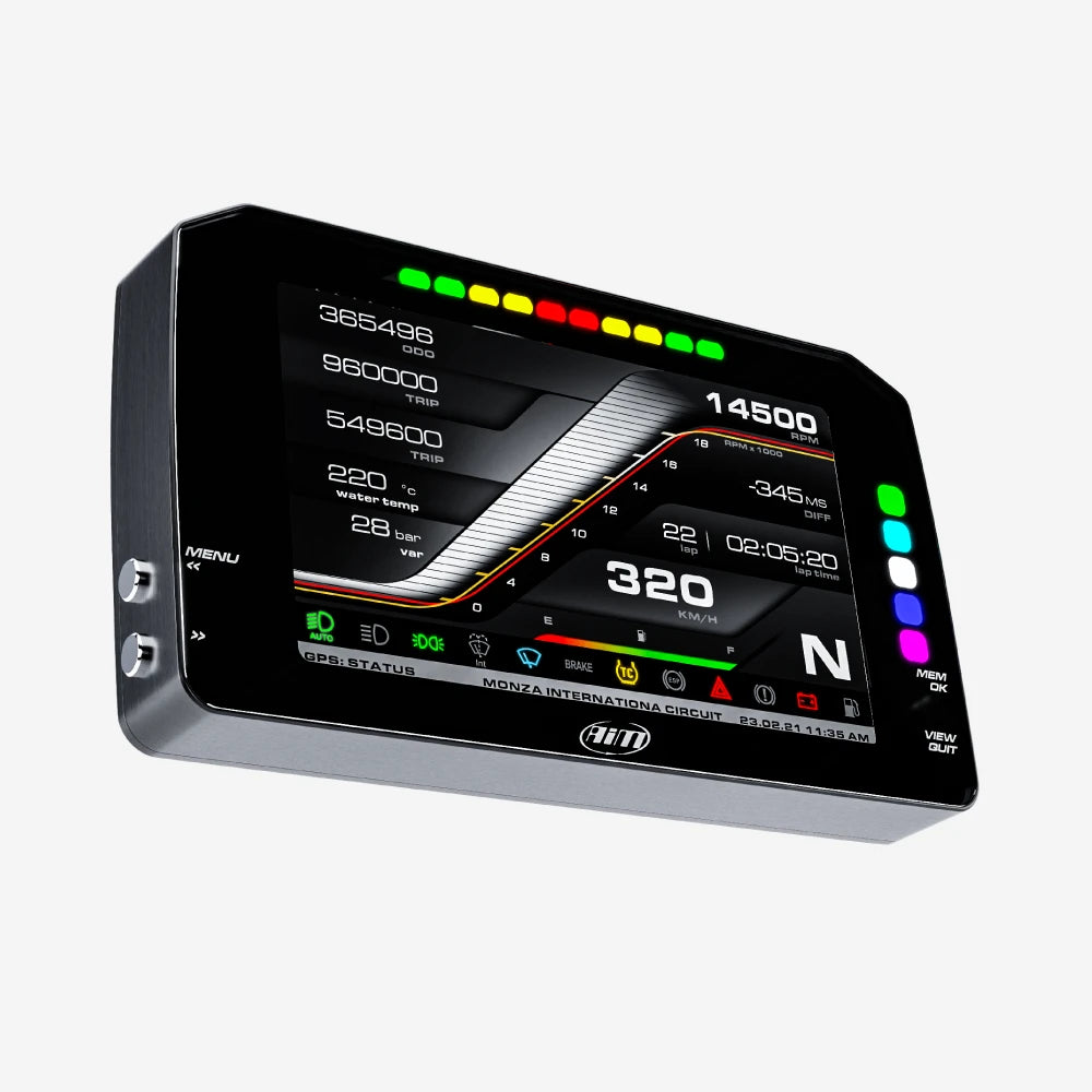

With integrated shift lights you can choose from a host of advanced multi-coloured RGB shift light patterns that can be customised to suit your requirements, and for each unique gear when required.
The MXP display logger also comes with 5 RGB LEDs, allowing you to customise colours, alarm types (solid or flashing), flashing frequency and accompanying text messages. Alarm priorities can be set to suit your specific requirements.
Ladda video: Pre-configured dash display screens for the MX Logger Series.
Configurable Pages
With a high contrast 6" TFT display, which is fully configurable, you can create and customise pages/displays to suit your requirements. Swapping pages can be managed by pushing one or two push buttons. An ambient light sensor adjusts the backlight for optimal brightness, ensuring clear visibility in all lighting conditions.

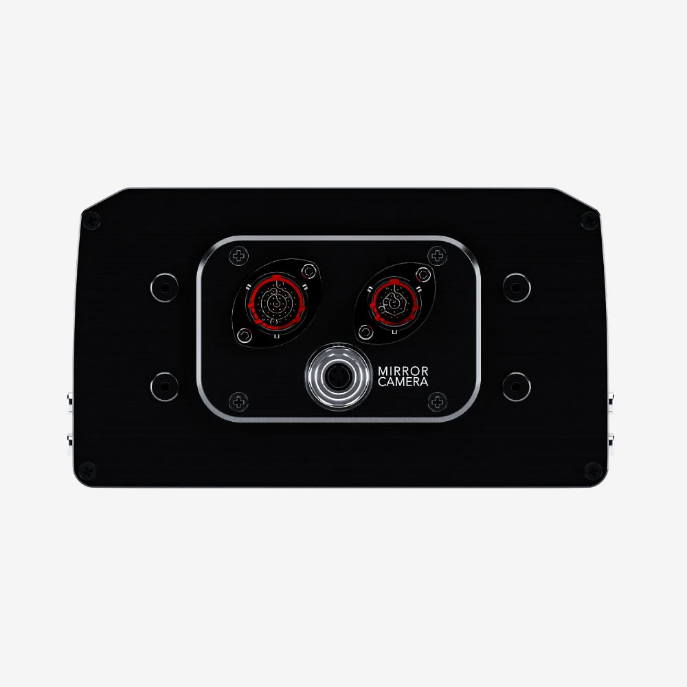

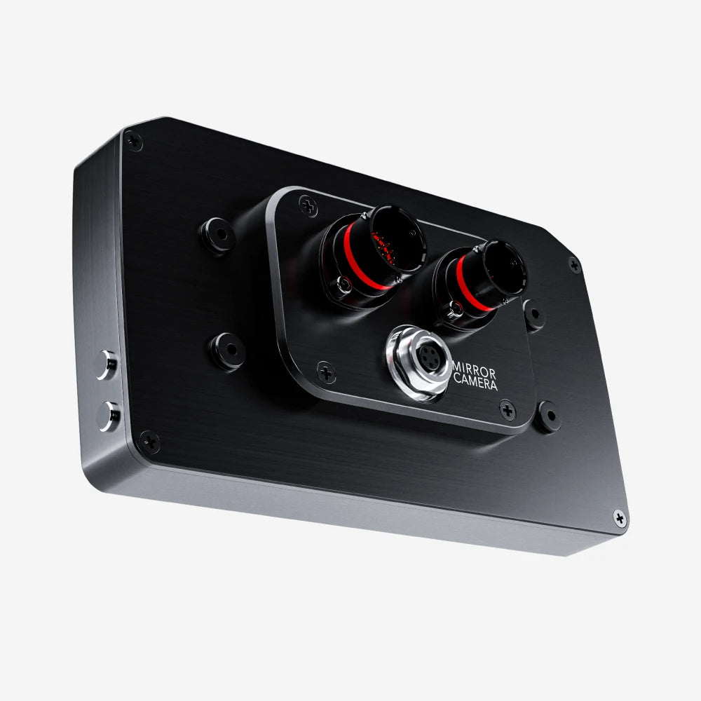

Two analogue camera inputs are available to switch your display into a mirror camera, through a push button command or event management. The camera is sold separately.

  • Expansions
The SmartyCam series also connects to record synchronised video and telemetry ready for analysis in Race Studio 3.

  • Expansion CAN Connection: GPS, Channel Expansion, Thermocouple Expansions, Lambda Controller, SmartyCam

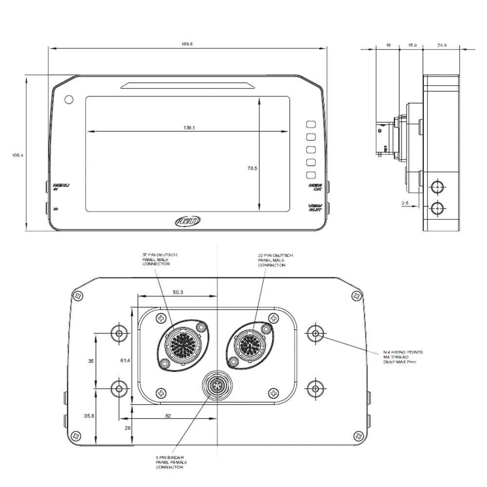

6" MXP Display Logger Diagram

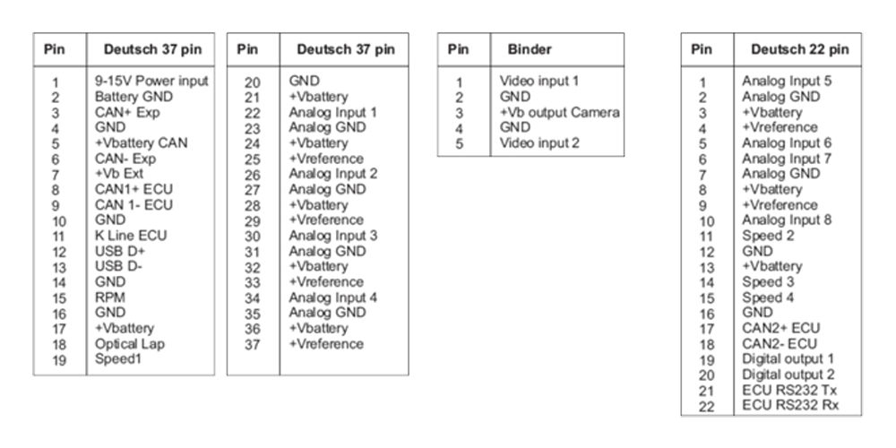

6" MXP Display Logger Pinout
