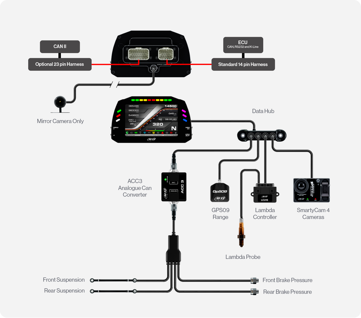

The MXS 1.3 Strada has a choice of ECU connections. Choose between the OBDII or K-Line CAN. Depending on whether you want to connect to the motorcycle's ECU using the OBDII port or directly to the ECU through the CAN channel.
Connecting the MXS 1.3 Strada dash to your motorcycle's ECU is simple; you can sample and display dozens of channels. This is usually the quickest and easiest setup, needing only 2 cable connections to the ECU instead of multiple connections to analogue sensors.
The sampled data depends on the actual ECU, but will typically include RPM, throttle position (TPS), oil, air, water temperature, oil pressure, battery voltage, speed, gear and lambda value (air/fuel ratio). The list of available ECU drivers is over 1,000 and is constantly being updated and upgraded.

Connecting an MX Strada Logger to your display enables it to log your data. With Race Studio 3, available to download on desktop or our mobile app, you can create, modify, delete, import and export configurations of:
  • All channels
  • ECU drivers
  • Math channels
  • Display pages
  • Digital outputs
  • Alarms
  • Shift lights
  • Expansions
MX Strada Series Expansions list; SmartyCam 3 GP, ACC3, Data Hub, GPS, and more.
Please Note: A 14-pin harness comes standard in the kit. Should you need more data, you can add our 23-pin harness as an optional extra.
