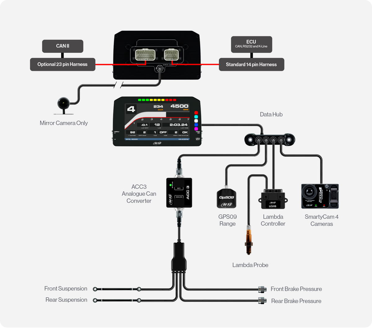

The MXP Strada features a 6" wide colour TFT display, offering a great visual impact. It is configurable to show data coming from the ECU, 9 axis inertial platform (accelerometer, GYRO and magnetometer). Eight analogue inputs, 6 digital inputs, pre-defined math channels, a second CAN and an optional GPS Module.
The MXP Strada is available with a choice of connection. Choose either the OBDII or K-Line CAN, depending on whether you want to connect to the vehicles ECU or OBDII port or directly to the ECU through the CAN channel.
Connecting the MXP Strada dash to your ECU is simple. You can sample and display dozens of channels straight from the vehicles ECU. This is usually the quickest and easiest setup, needing only 2 cable connections to the ECU instead of multiple connections to analogue sensors. The sampled data depends on the actual ECU, but will typically include RPM, throttle position, (TPS), oil, air, water temperature, oil pressure, battery voltage, speed, gear, lambda value (air/fuel ratio). The list of available ECU drivers is 1000+ and is constantly being updated and upgraded.

The MXP Strada has a choice of ECU connection. Choose between the OBDII or K-Line CAN. Depending on whether you want to connect to the vehicles ECU using the OBDII port or directly to the ECU through the CAN channel.
These are only some of the items that can be added to our MXP Strada for incrementing the performance and the data acquired.
