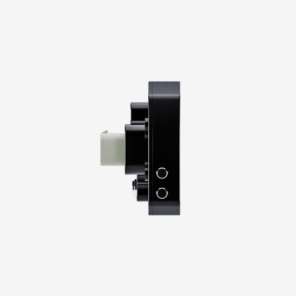

The MXS Strada with race icons is one of the most widely used dash displays on tracks around the world. The MXS 1.3 Strada has a compact 5" colour TFT display that offers a great visual impact. You can configure the dash to show all the information coming from the motorcycle’s ECU, analogue/digital inputs, predefined math channels and an optional GPS Module.
The MXS Strada 5" Display integrated into a motorcycle setup.
The MXS Strada Display is an HD digital display, designed for motorcycle riders who need essential data visibility while on the track or road. The dashboard is tailored to show real time data such as speed, RPM and temperatures, but doesn't include data logging functionalities natively.

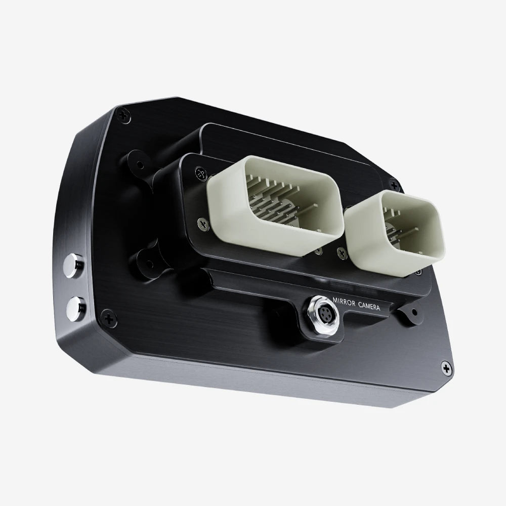

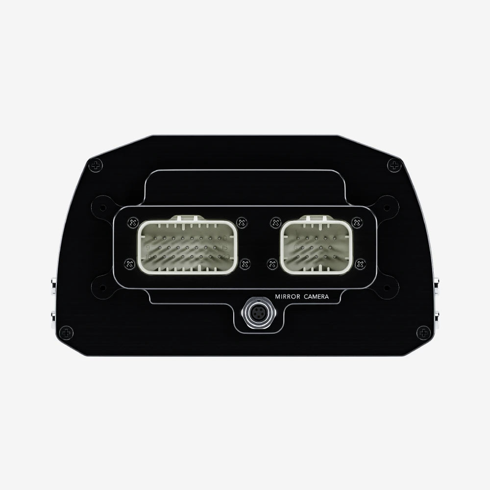

The MXS 1.3 Strada has a choice of ECU connections. Choose between the OBDII or K-Line CAN. Depending on whether you want to connect to the motorcycle's ECU using the OBDII port or directly to the ECU through the CAN channel.
Connecting the MXS 1.3 Strada dash to your motorcycle's ECU is simple; you can sample and display dozens of channels. This is usually the quickest and easiest setup, needing only 2 cable connections to the ECU instead of multiple connections to analogue sensors.
The sampled data depends on the actual ECU, but will typically include RPM, throttle position (TPS), oil, air, water temperature, oil pressure, battery voltage, speed, gear and lambda value (air/fuel ratio). The list of available ECU drivers is over 1,000 and is constantly being updated and upgraded.

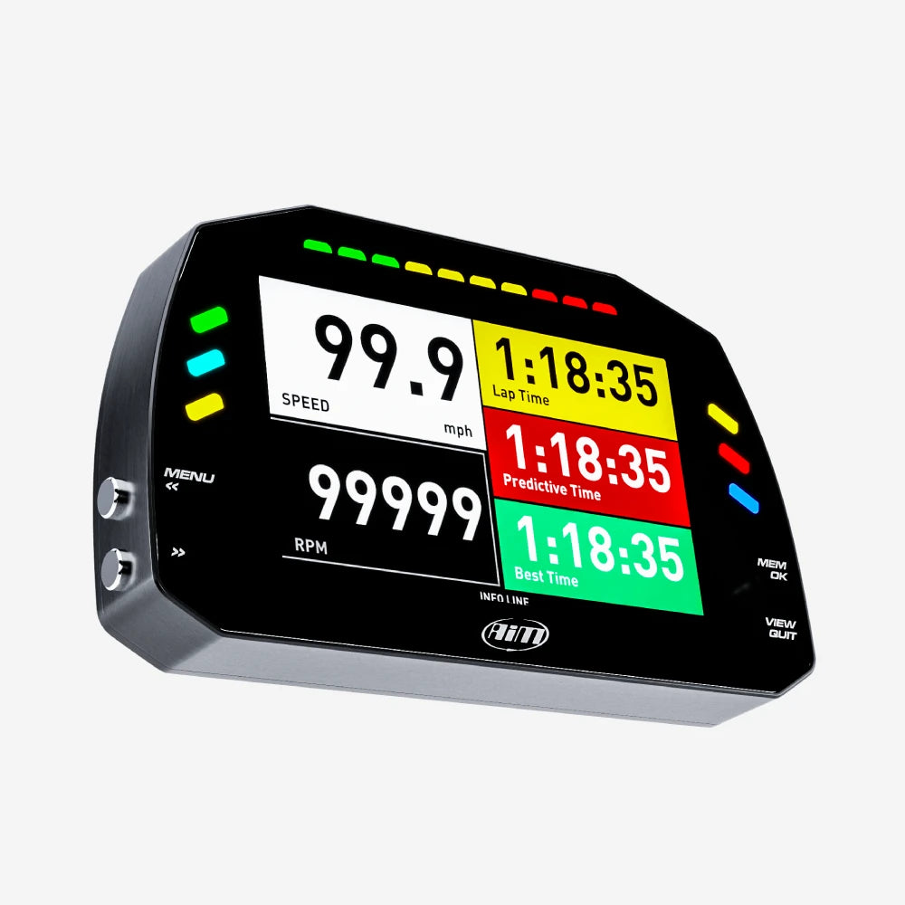

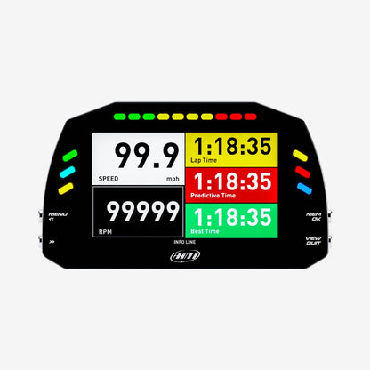

The MXS 1.3 Strada has a 5" TFT high contrast colour display. The visual quality is optimised by the ambient light sensor, which keeps the backlight at the best brightness levels. Race icons allow you to apply conditions to the LED icons.
Pre-Configured Pages

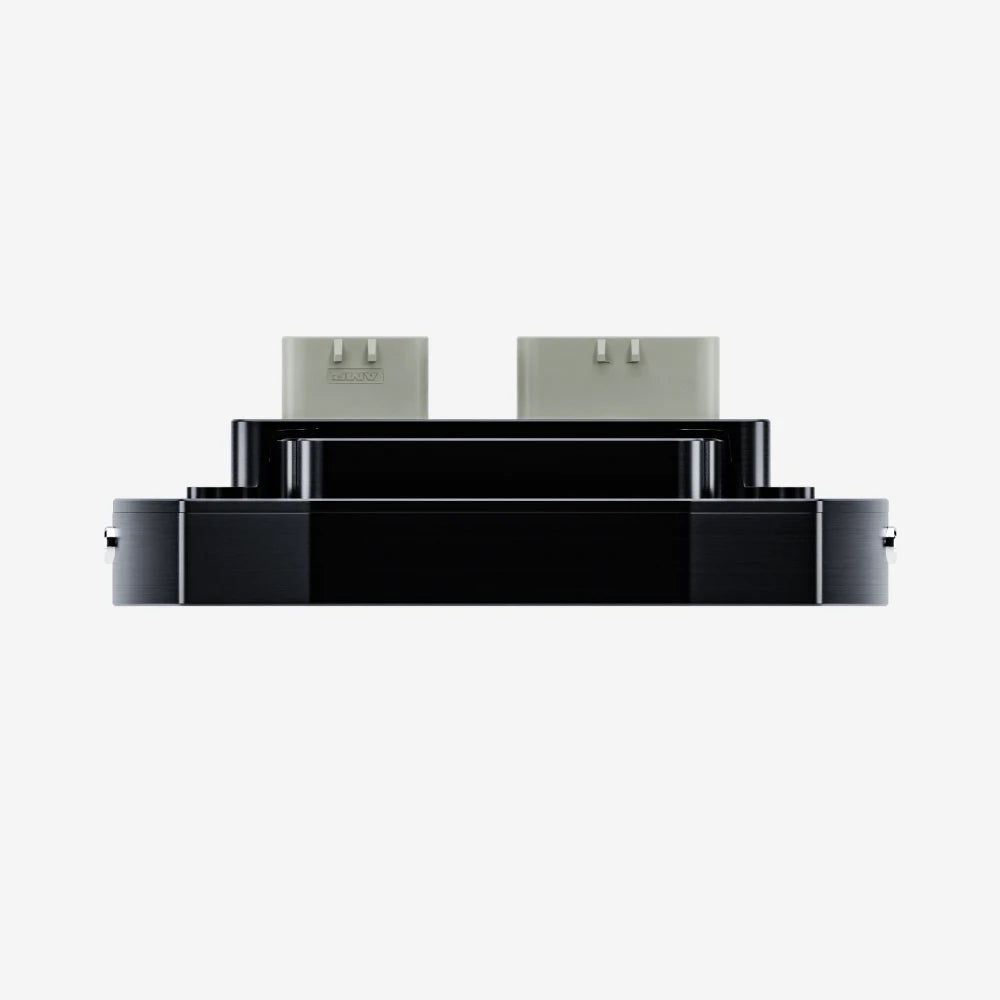

Please Note: A 14-pin harness comes standard in the kit. Should you need more data, you can add our 22-pin harness as an optional extra.
  • Ambient Light Sensor: Yes
  • CAN Connections: 2
  • Second CAN: Yes
  • Body: Anodised aluminium
  • Power Consumption: 400mA
  • Display: 5" TFT
  • Contrast: 600:1
  • Weight: 480g
