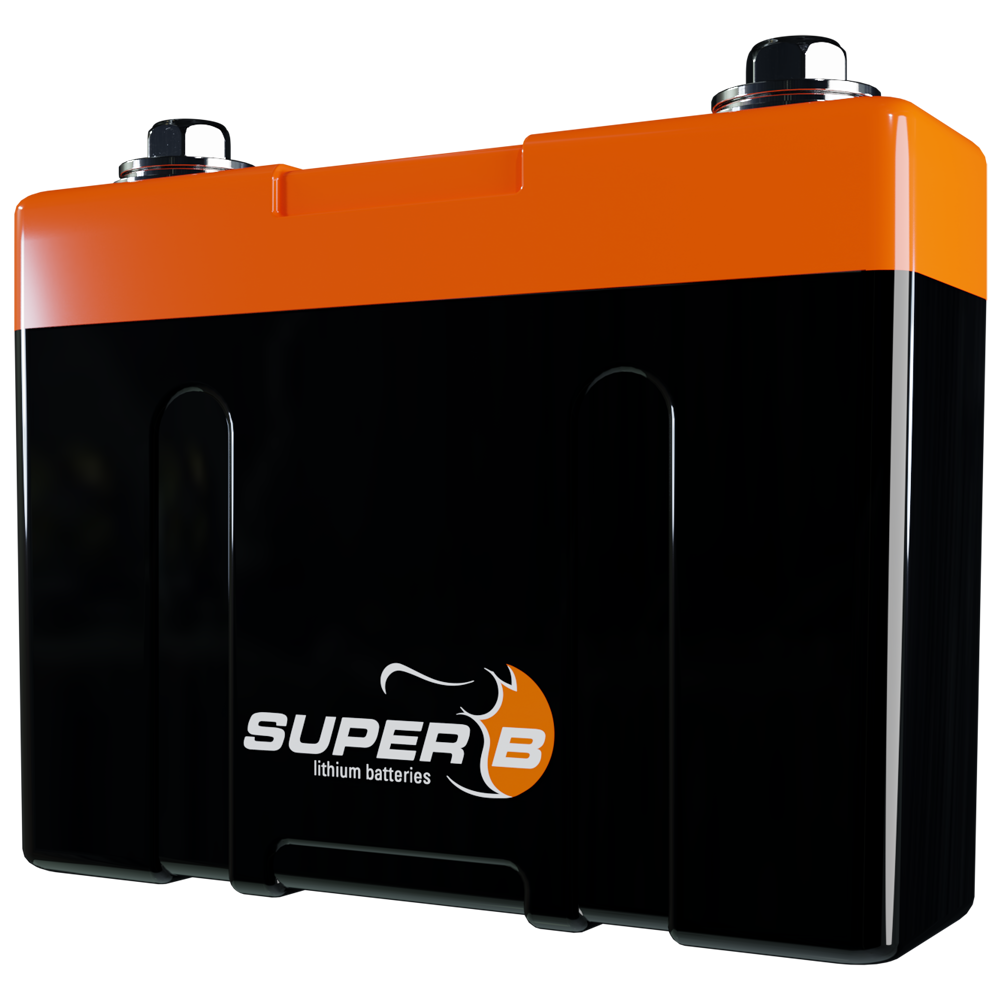

The Super B Andrena 12V2.5Ah Lithium Battery is compact in size, measuring in at 114 x 32 x 84mm and weighing just 0.46kg, so it is perfect for karts that need a smaller power source with high energy capacity.
At only 1/3 of the size of traditional lead-acid batteries, the Super B Andrena 12V2.5Ah Lithium Battery not only simplifies maintenance and installation in tight engine bays, but it also improves fuel economy and performance, delivering sharper handling, quicker acceleration and less strain on suspension components.
High-Performance
The Super B Andrena 12V2.5Ah Lithium Kart Battery delivers exceptional power with a stable and flat discharge curve, meaning over 80% of its capacity is usable. It supports high continuous and pulse discharge currents, making it ideal for demanding karting applications.
Fast charging in as little as 25 minutes minimises downtime, while a long cycle life of over 1,000 full discharges ensures reliable, maintenance-free performance. With a self-discharge rate of less than 3% per month, the battery holds its charge for extended periods, allowing the kart to remain unattended much longer than with traditional lead-acid batteries.
Safe & Reliable
Due to its LiFePO4 technology, which is renowned for its thermal and chemical stability, the Super B Andrena Battery is amongst the safest lithium technologies on the market. As well as the technology, the Andrena Battery casing is made from PC-ABS with an ingress protection rating of IP69. These features make the battery completely dust-tight and waterproof, which is ideal for extreme karting environments.
