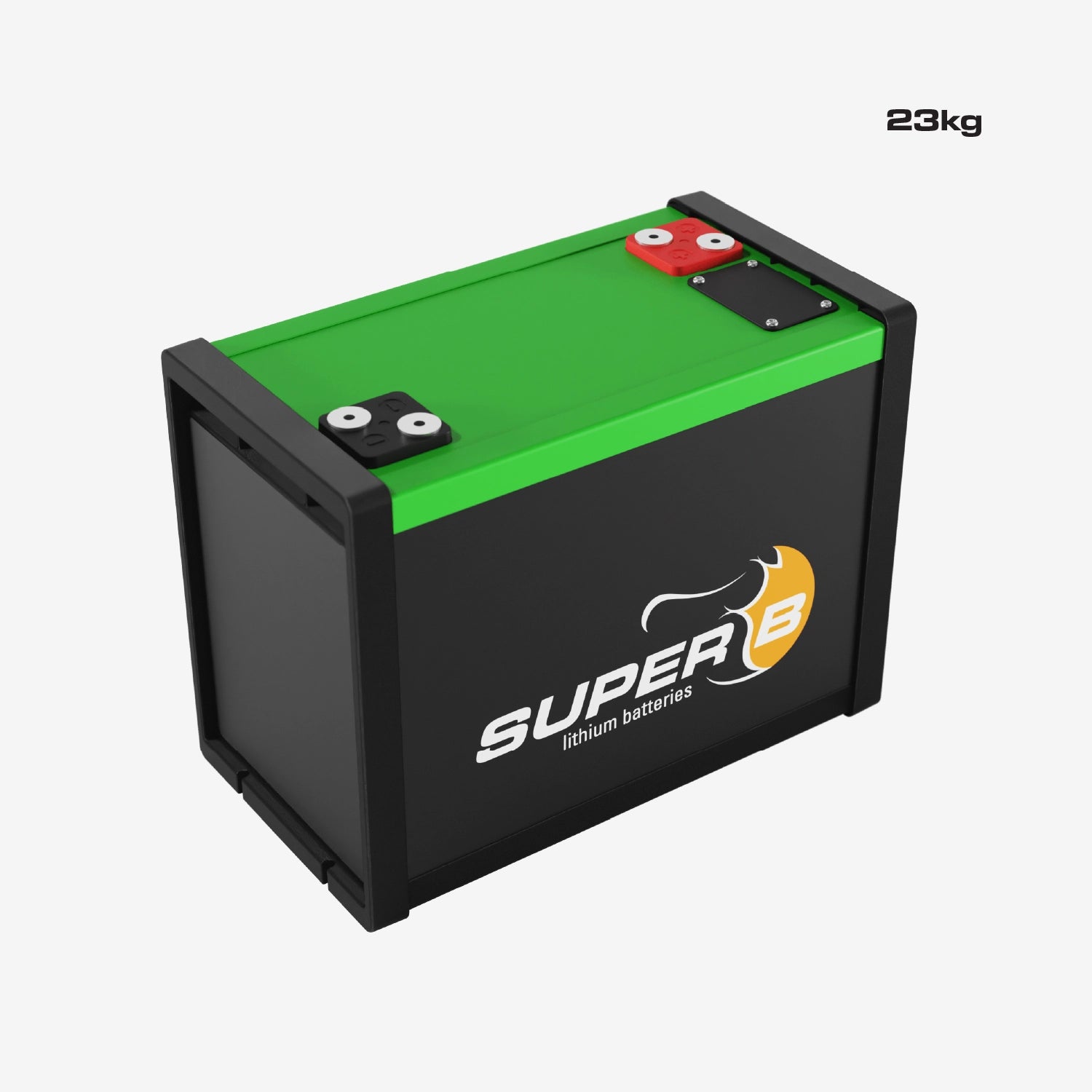

Engineered by Super B Energy, the Nomia 12V210Ah Battery delivers reliable lithium power with advanced safety, monitoring and thermal performance. Its advanced technology and smart software make this lithium battery a robust, low-maintenance, high-efficiency, safe and user-friendly energy storage solution, offering significant weight and space savings compared to traditional lead-acid batteries.

Despite its strong output, the battery remains compact and lightweight at just 417 x 227 x 314mm and 23kg, making it ideal for space-sensitive applications. The Nomia Battery also supports fast charging up to 210A, delivers high discharge currents and has a low self-discharge rate under 3% per month, ensuring that the battery retains its charge, even when not in use—ideal for seasonal applications.
