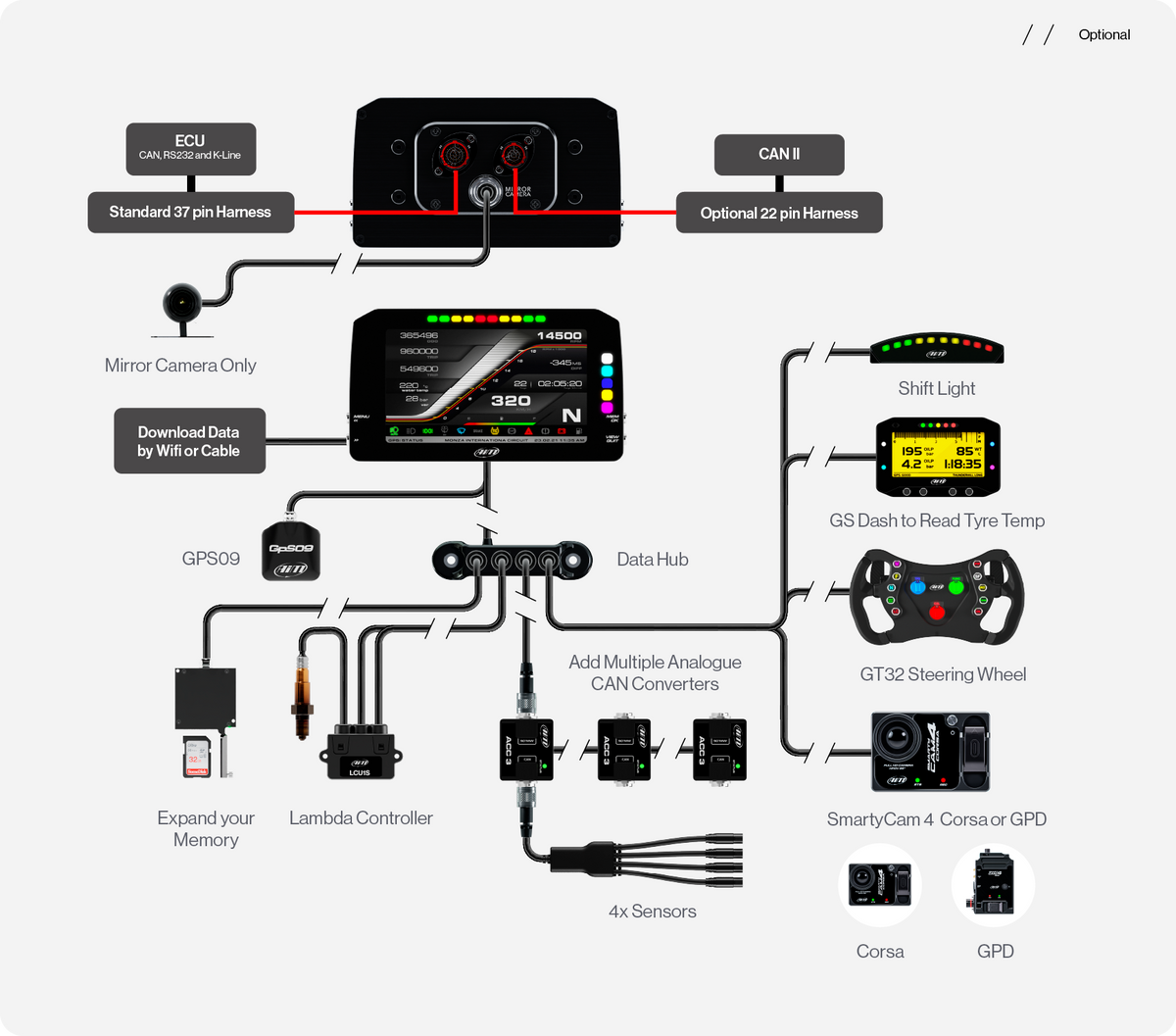

Connecting the MXP 1.3 dash to your car's ECU is simple. You can sample dozens of channels straight from the ECU. This is usually the quickest and easiest setup, needing only a cable connection to the ECU instead of multiple connections and analogue sensors.
The sampled data will depend on your actual ECU, but typically includes RPM, engine load, throttle position (TPS), oil, air, water temperature, oil pressure, battery voltage, speed, gear and lambda value (air/fuel ratio). The list of available ECU drivers is constantly updated and upgraded, and includes over 1,000 different ECUs.

  • Expansion CAN Connection: GPS, Channel Expansion, Thermocouple Expansions, Lambda Controller, SmartyCam
