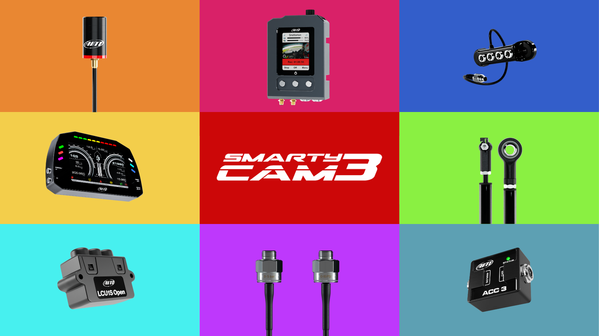

Expand your SmartyCam 3 GP with an MXS display, ACC3, Data Hub and sensors
Overlay your delta, predictive, timing splits, lap data and more in Race Studio 3 when you pair the SmartyCam 3 GP with the Aim Solo 2 DL GPS lap timer. Expand your system further with additional sensors and expansions such as the ACC, LCU-One S, Data Hubs, sensors and more. Please see the connections tab for connection examples.
