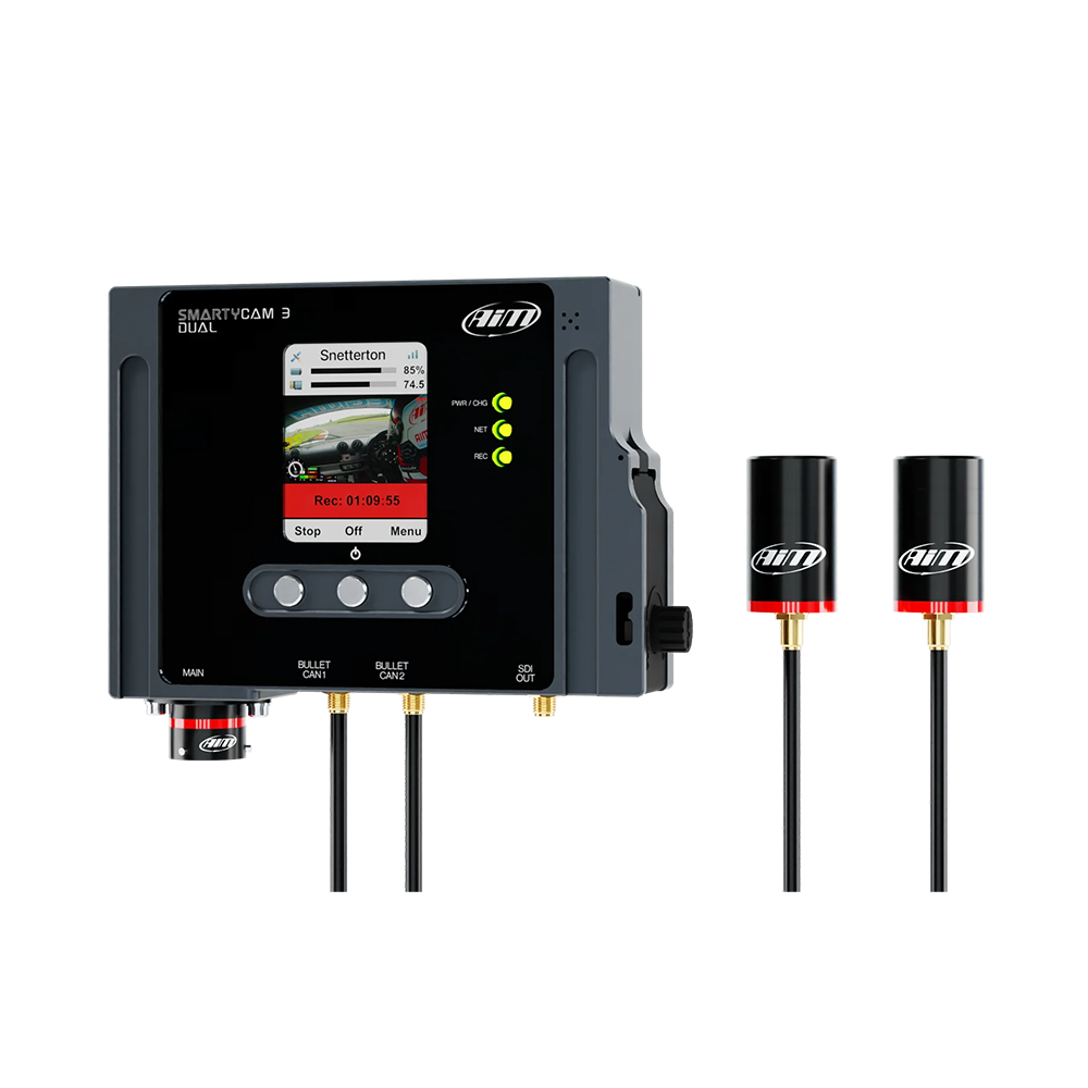

The Aim SmartyCam 3 Dual is the best onboard dual motorsport camera system in our range, designed for any racer who wants to get the most out of any performance video on the track and in the pits.
Please Note:  The camera MUST be externally powered as the internal battery is only designed for initial configuration.
Load video: SmartyCam footage in motorsport setup
Why Choose the Aim SmartyCam 3 Dual
The Aim SmartyCam 3 Dual is a professional onboard motorsport system with 2 bullet cameras. It automatically powers on and off in-sync with your engine and will auto start/stop recording based on parameters you set. It saves all your information to a supported SD card for up to 2TB of data, including speed, RPM, lap number, gear shifts and more.
Data from the SmartyCam 3 Dual can be analysed from a vast range of sources such as ECU information, GPS information, track map, vehicle position, speed, lap & split times. With IP65 waterproof, wobble-resistant global shutter CMOS sensor, and machined aluminium that allows the camera to withstand extreme temperatures and severe weather circumstances, your performance will hit the next level.

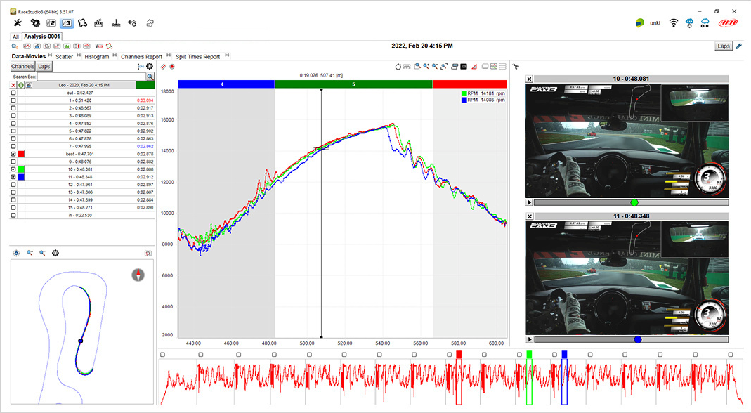

With Race Studio 3 software you can also configure your overlay. Add your logo and track map; choose your graphic elements from a list of pre-determined sets with the same layout or even single objects from different sets, and your videos will be truly yours.

Video Output/Streaming
The SmartyCam 3 Dual features a video output with an SD interface. It allows you to send the video/audio directly to wherever you choose, for example your pit crew, at 30 or 60fps.
Two Video Inputs
With two video inputs, you can film from two locations on your vehicle, which can be displayed on 'Picture in Picture’ using Race Studio 3. This allows you to overlay and analyse your driving from any two angles in or out of the vehicle.

Picture in Picture
Overlay your videos with our all-new 'Picture in Picture' effect. Pick your angles and align your dual bullet cameras accordingly. In your post-race analysis in Race Studio 3, you can overlay all angles with your data and analyse from a picture-in-picture standpoint.
