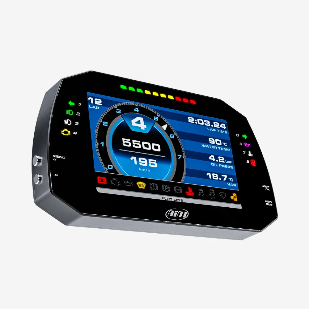

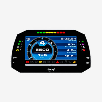

The MXG 1.3 Strada IVA-compliant dash has a 7" TFT high contrast colour display. The visual quality is optimised by the ambient light sensor, which keeps the backlight at the best brightness levels.
Video laden: Pre-configured dash display screens for the MX Strada Series.
Pre-Configured Pages
The MXG 1.3 Strada IVA dash shows the RPM scale and all the data you need, like speed, water temperature and oil pressure, lap times and much more. You can customise pages to suit your requirements, including up to four additional fields. Define what data is shown with the end of scale and measure units. Swapping between the pages is easy; just use the push buttons.

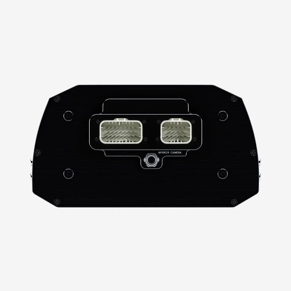

Turn your MX Strada IVA Dash into a complete data logging system with the MX Strada Logger, Data Hub & GPS09 Module. You can also integrate an ACC3 and convert your analogue to CAN, integrating a camera and various sensors into your setup.
  • Ambient Light Sensor: Yes
  • Alarm LEDs: 8 RGB, freely configurable
  • CAN Connections: 2
  • External Modules: GPS Module, Channel Expansions, TC Hub, Lambda Controllers, SmartyCam
  • Digital Inputs: 1-speed input, coil RPM input
  • Digital Outputs: 1 (1A max)
  • Second CAN: Yes
  • Body: Anodised aluminium
  • Power Consumption: 400mA
  • Display: 7" TFT
  • Contrast: 1000:1
  • Weight: 950g

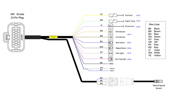

IVA Loom Diagram
What are the differences between the MXG Strada IVA-Compliant Displays and the MXG Strada Display?

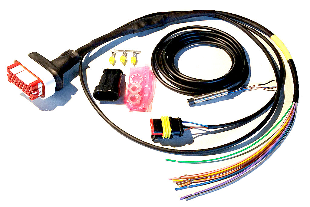

The main difference between the MXG Strada IVA-Compliant Display and the MXG Strada Display is that the IVA version has an IVA-specific second harness that comes with the display kit, providing essential road lighting indicators (turn signals, fog lights, etc.) to meet UK Individual Vehicle Approval (IVA) standards. While both have a 7" display and ECU compatibility, the IVA dash provides a plug & play solution for road-legal kit cars. For a full comparison of the MX Strada Series, take a look at the comparison tab.
