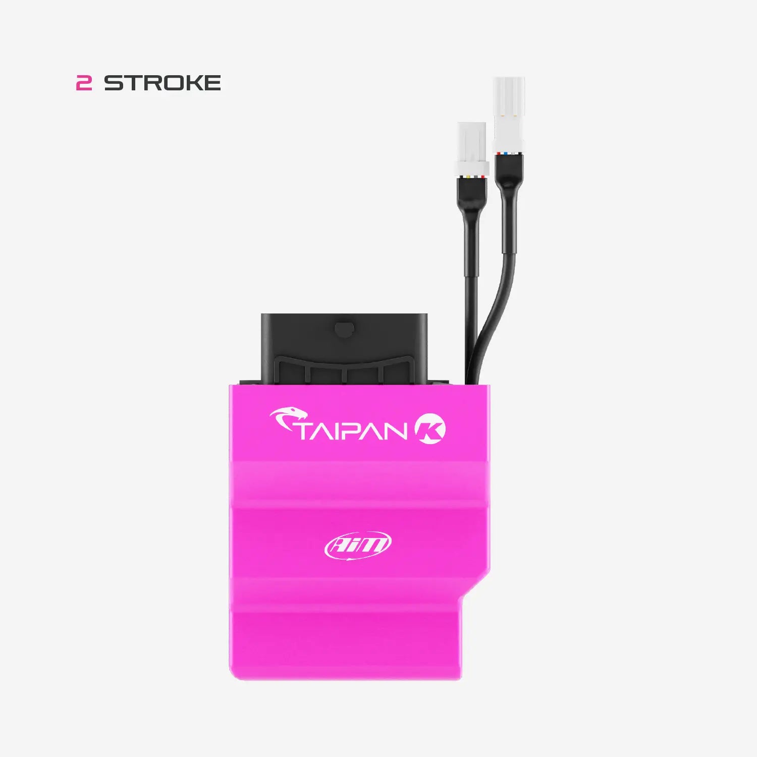

Taipan are the aftermarket plug & play ECU created by Aim, exclusively designed for plug & play installation for motocross/off-road motorcycles. The latest addition, the Taipan K, was specifically designed for 2-stroke KTM/Husqvarna/GASGAS 2024.
Why Choose the Taipan K ECU
Thanks to their high technology 32-bit core, the Taipan K ECU represents an important step forward to improve the performance of your motorcycle, without sacrificing reliability and smoothness.
The Taipan K ECU is unprogrammed and can be configured for the 2-stroke KTM/Husqvarna/GASGAS 2024. You will need the UC Bridge Tuner to enable this process.
The Taipan K ECU provides ultimate control over ignition, ignition phase, start maps, launch control, and traction control, with altitude and engine temperature corrections.

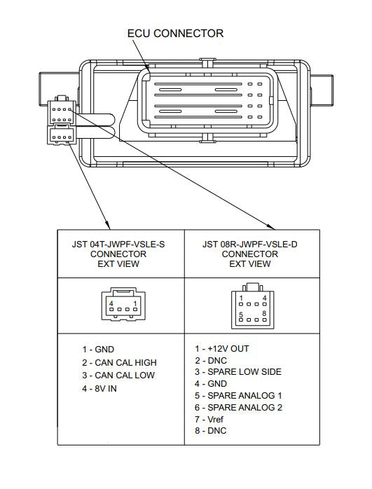

Taipan K ECU Connections

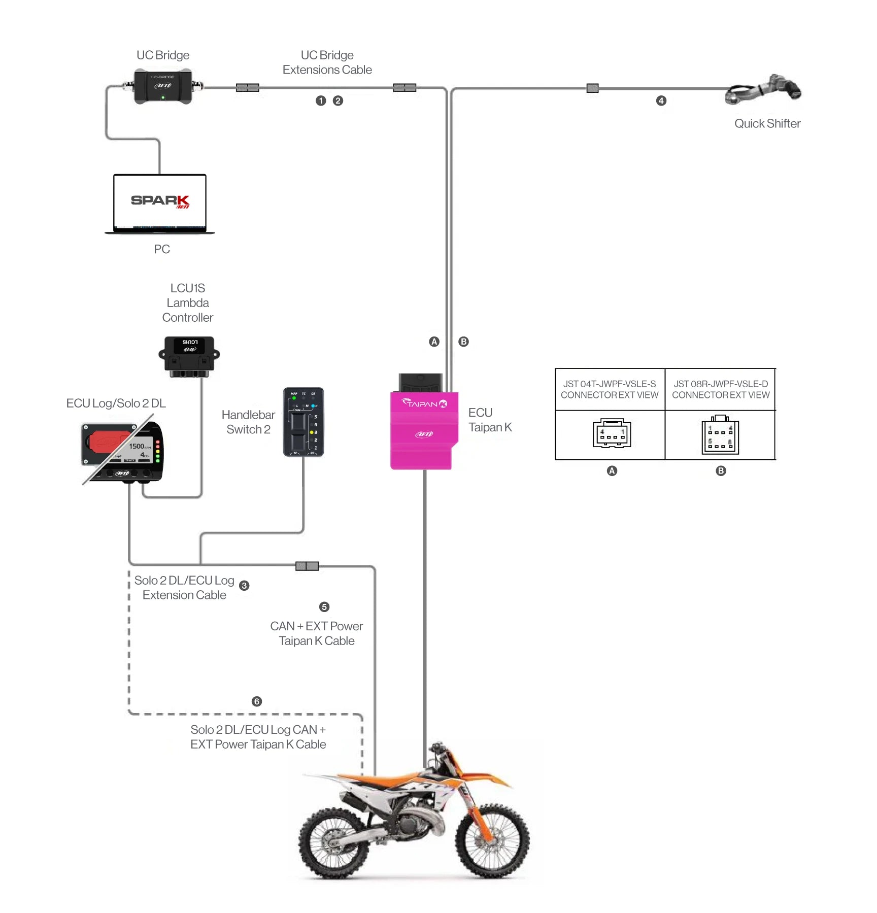

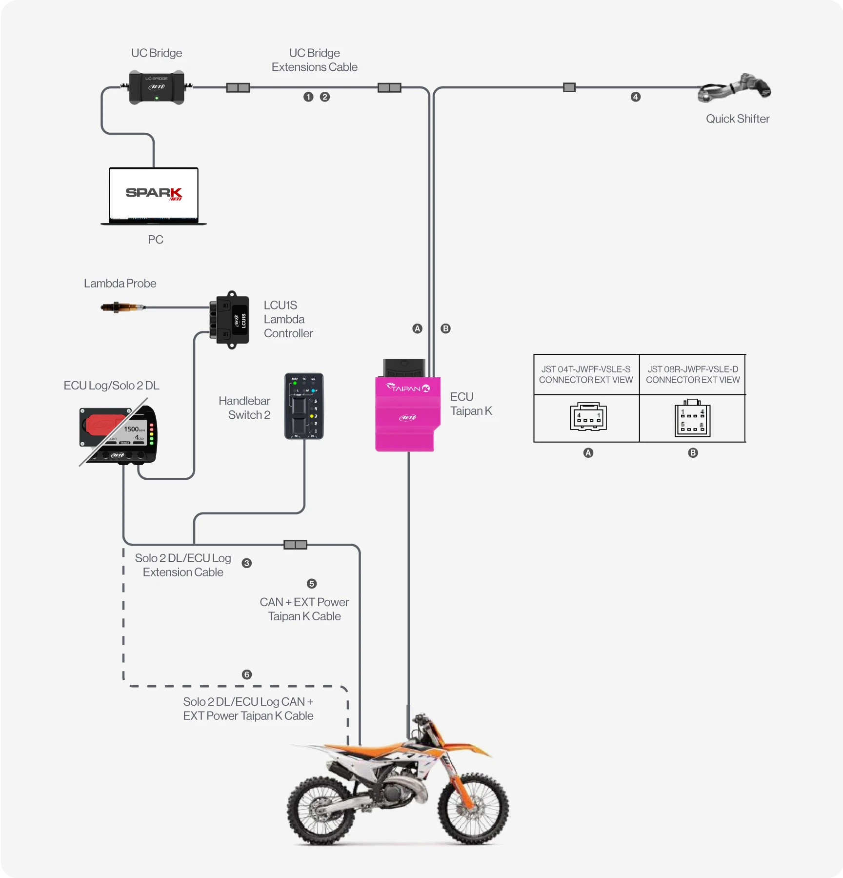

The Taipan K ECU has 3 connectors:
  • Main Connector: Compatible with 2-stroke KTM/Husqvarna/GASGAS 2024.
  • CAN Connector: Connects to the Handlebar Switch 2 and data logger.
  • 2nd CAN Connector: Connects to the UC Bridge to communicate with the PC.

Connect your smartphone to the Taipan and ECU in two ways:
  • Via the CAN-BT Module, for instant access to key engine data and real-time telemetry.
  • Using the XLog, if you want to collect data while driving as well.
The Taipan K ECU Expansion list; Solo 2 DL, SmartyCam 3, Handlebar Switch 2, UC-Bridge and more
The Taipan ECU works seamlessly with Aim’s ecosystem of devices.
  • CAN-BT Module: The CAN-BT Module grants instant access to key engine data from your Taipan ECU. Install the SPARK App on your smartphone for a streamlined, data-driven interface for real-time monitoring of live engine parameters.
  • Handlebar Switch 2: HBS2 is the compact, high-performance, and durable Handlebar Switch. If you're looking for a highly flexible and ergonomic switch, the model from Aim offers a great solution with 4 push buttons and 11 integrated LEDs.
  • UC-Bridge: The UC Bridge serves as the essential interface connection between the CAN bus of the ECU and the USB port of your PC.
  • Data Hub: Split EXP ports to connect multiple expansions such as the Solo 2 lap timer, UC Bridge, Handlebar Switch or additional converters.

Connectors
  • 1 JST 04T-JWPF-VSLE-S connector
  • 1 JST 08R-JWPF-VSLE-D connector
  • 1 64-pin male connector
  • Dimensions: 112 x 100 x 40.8mm
  • Weight: 390g
  • IP67
