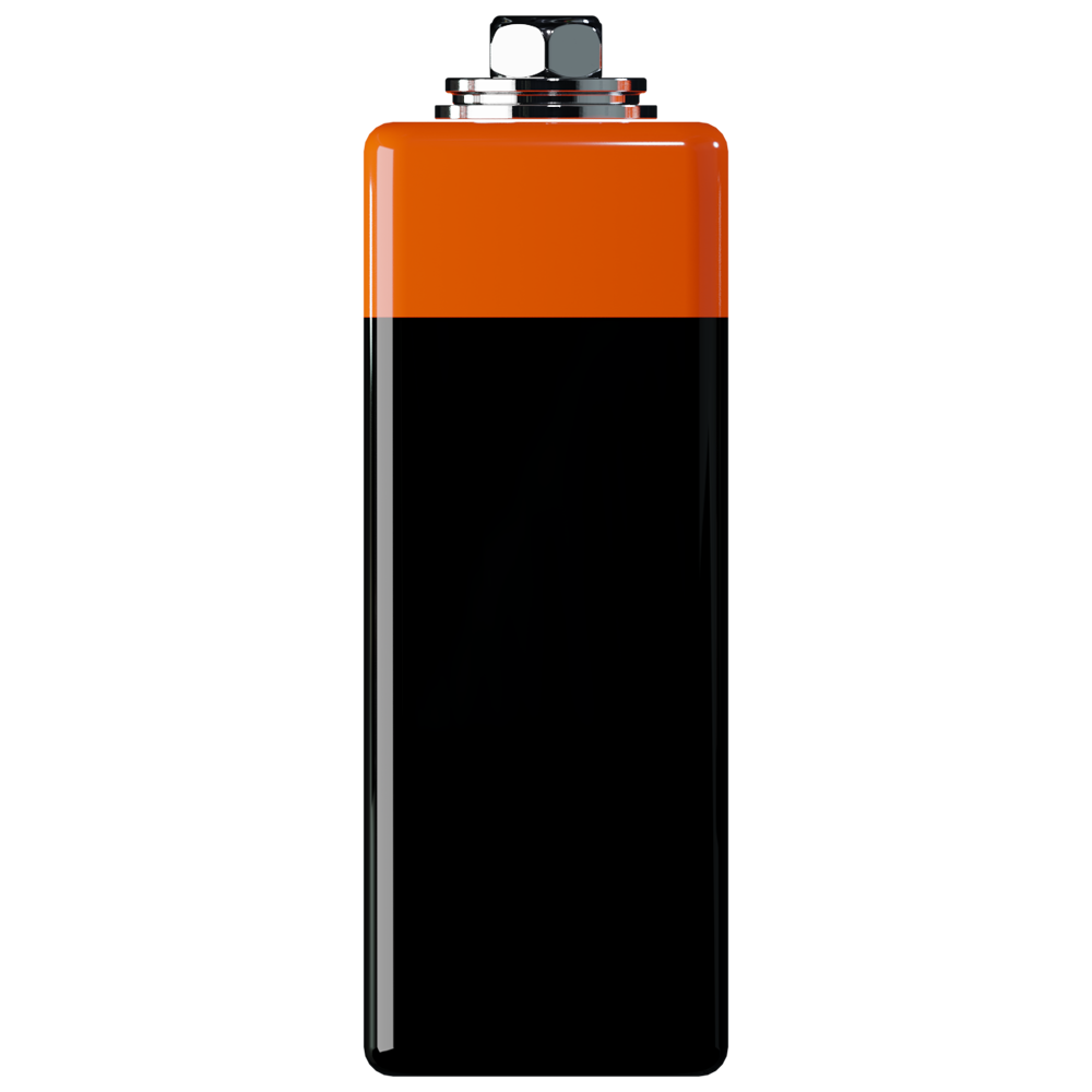

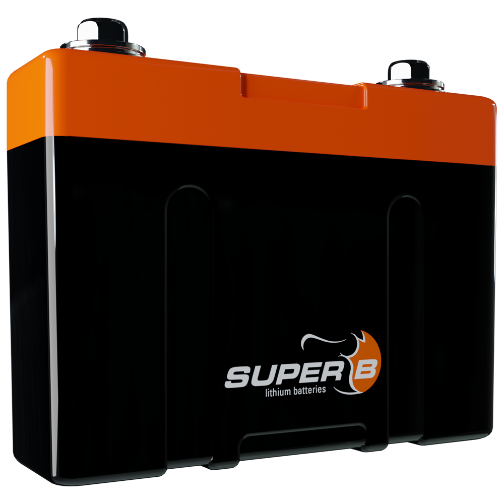

The Super B Andrena 12V2.5Ah Lithium Battery is compact in size, measuring in at 114 x 32 x 84mm and weighing just 0.46kg, so it is perfect for karts that need a smaller power source with high energy capacity.
At only 1/3 of the size of traditional lead-acid batteries, the Super B Andrena 12V2.5Ah Lithium Battery not only simplifies maintenance and installation in tight engine bays, but it also improves fuel economy and performance, delivering sharper handling, quicker acceleration and less strain on suspension components.

  • Dimensions (LxWxH): 114 x 32 x 84mm / 4.49” x 1.26” x 3.30”
  • Weight: 0.46kg / 1.0lbs
  • Case Material: PC - ABS
  • Ingress Protection: IP69
