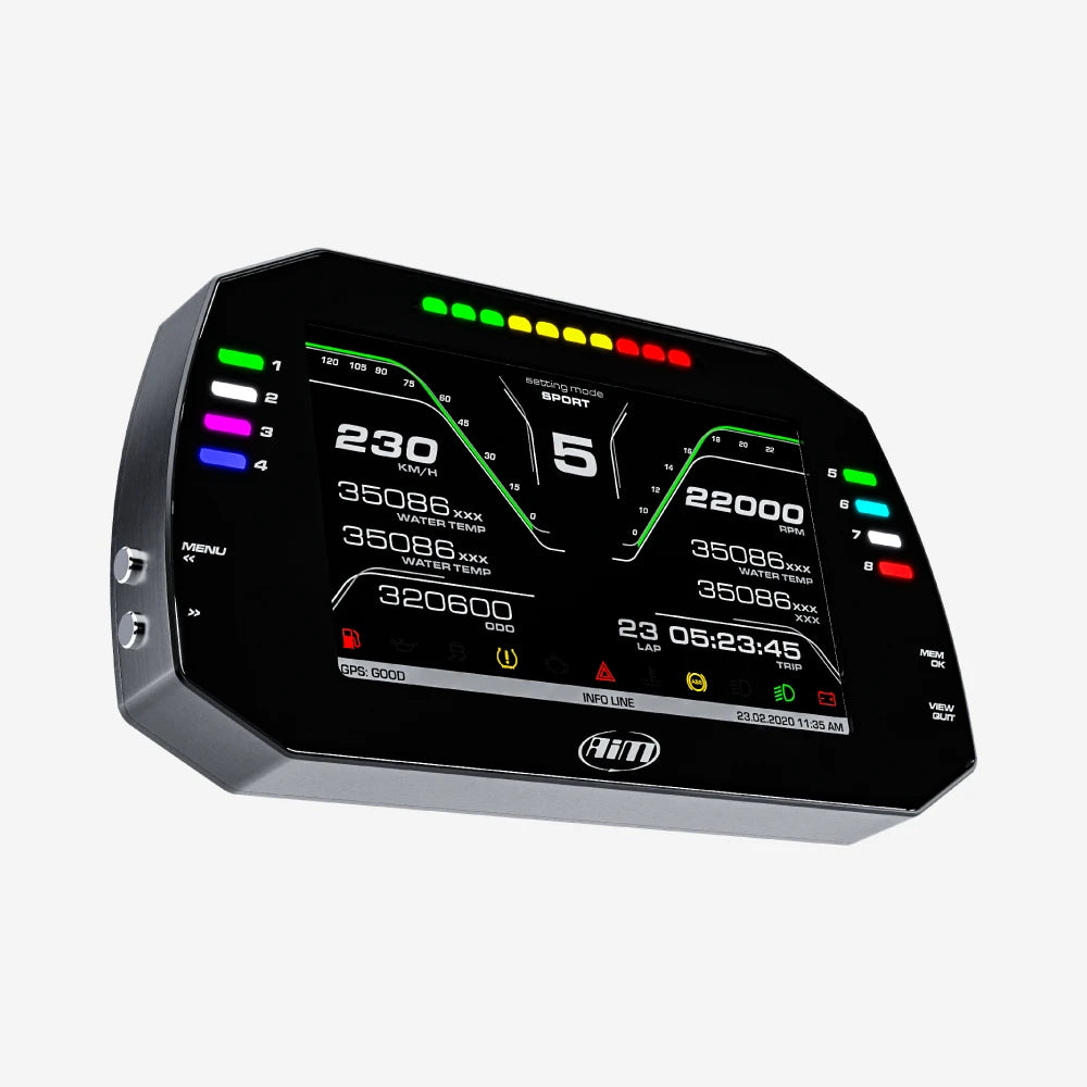

The MXG 1.3 dash logger has a 7" TFT digital display, which has been designed to acquire and display data coming from the ECU. It is an ideal choice for racers who want valuable data at their fingertips.
Note: The MXG Strada option is also available with road icons to suit a variety of vehicle applications.
The MXG 7" Car Dash Display & Data Logger on a workbench in a garage
Why Choose the MXG 1.3 Car Dash Display & Data Logger
The Aim MXG 1.3 is a compact, but powerful motorsport display and data logger. It offers real time data on its 7” TFT screen, has customisable display layouts, lap timing capabilities thanks to the GPS09 Module (included in the kit), and is compatible with a range of Aim devices and expansions for the ultimate setup.
A Range of Data Sources

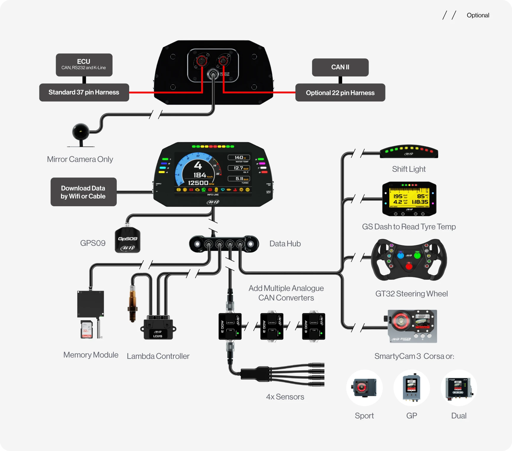

The MXG digital dash is designed to collect and display data from the ECU, the internal accelerometer & gyro, the included GPS09 Module, analogue & digital inputs, and predefined math channels. You can also expand its capabilities by adding up to 8 modules to enhance performance and data acquisition.
Connecting the MXG 1.3 dash to your car’s ECU is simple. You can sample dozens of channels straight from the car's ECU (compatible with over 1,000 different ECUs), requiring only a cable connection to the ECU instead of multiple connections and analogue sensors.

The MXG display logger also comes with 8 RGB LEDs, allowing you to customise colours, alarm types (solid or flashing), flashing frequency and accompanying text messages. Alarm priorities can be set to suit your specific requirements.

Configurable Pages
With a high contrast 7" TFT display, which is fully configurable, you can create and customise pages/displays to suit your requirements, choosing from a variety of styles, data types and measurement units. An ambient light sensor adjusts the backlight for optimal brightness, ensuring clear visibility in all lighting conditions.

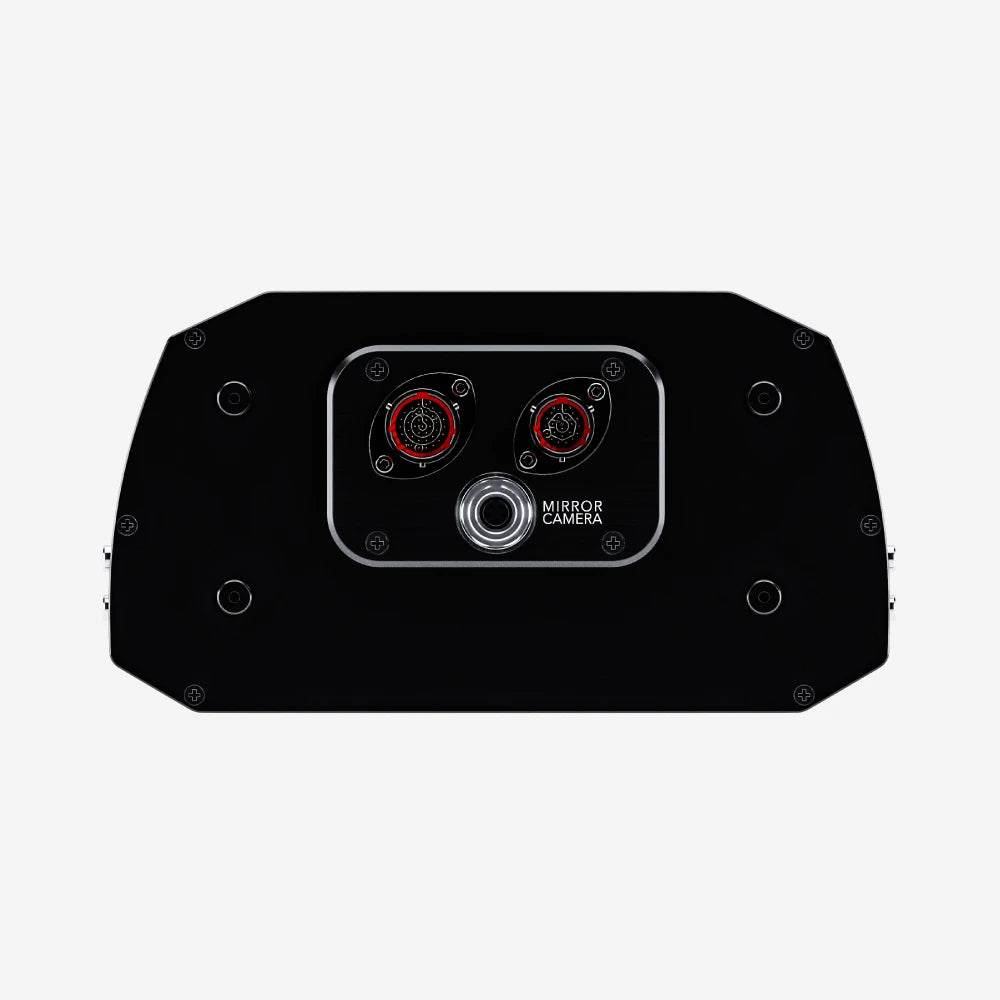

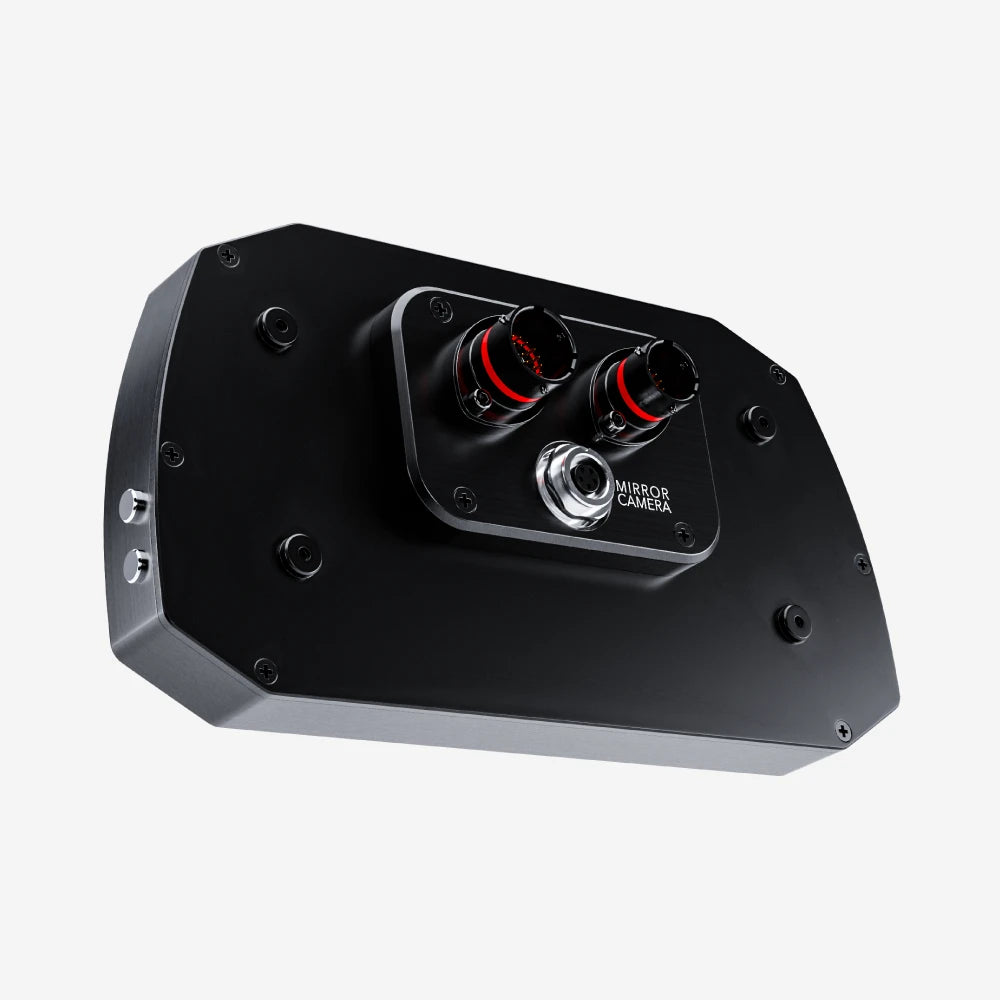

Two analogue camera inputs are available to switch your display into a mirror camera, activated by a push button or event. The camera is sold separately.

MX Logger Series Expansions list; SmartyCam, ACC3, Data Hub, GPS, and more.
The LCU-One S allows you to perfectly tune the carburetion of your engine to keep it at its best and improve the engine's performance. Alongside the Analogue CAN Converter, you can choose among 5 different split harnesses. Up to 4 thermocouples or 4 analogue channels 0-5V/0-12V are available.
The SmartyCam camera series also connects to record synchronised video and telemetry ready for analysis in Race Studio 3.

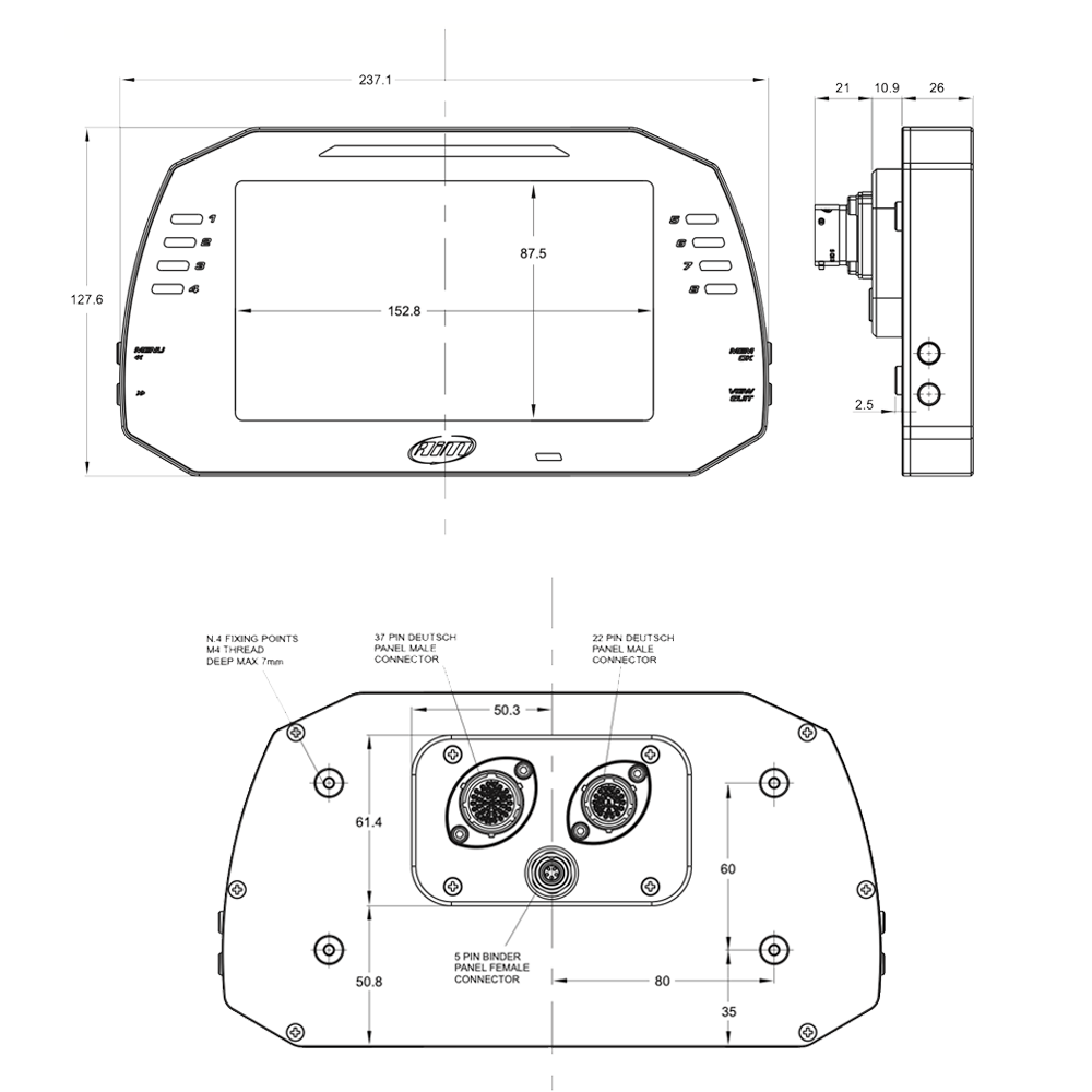

Aim MXG Datalogger Display dimension diagram
