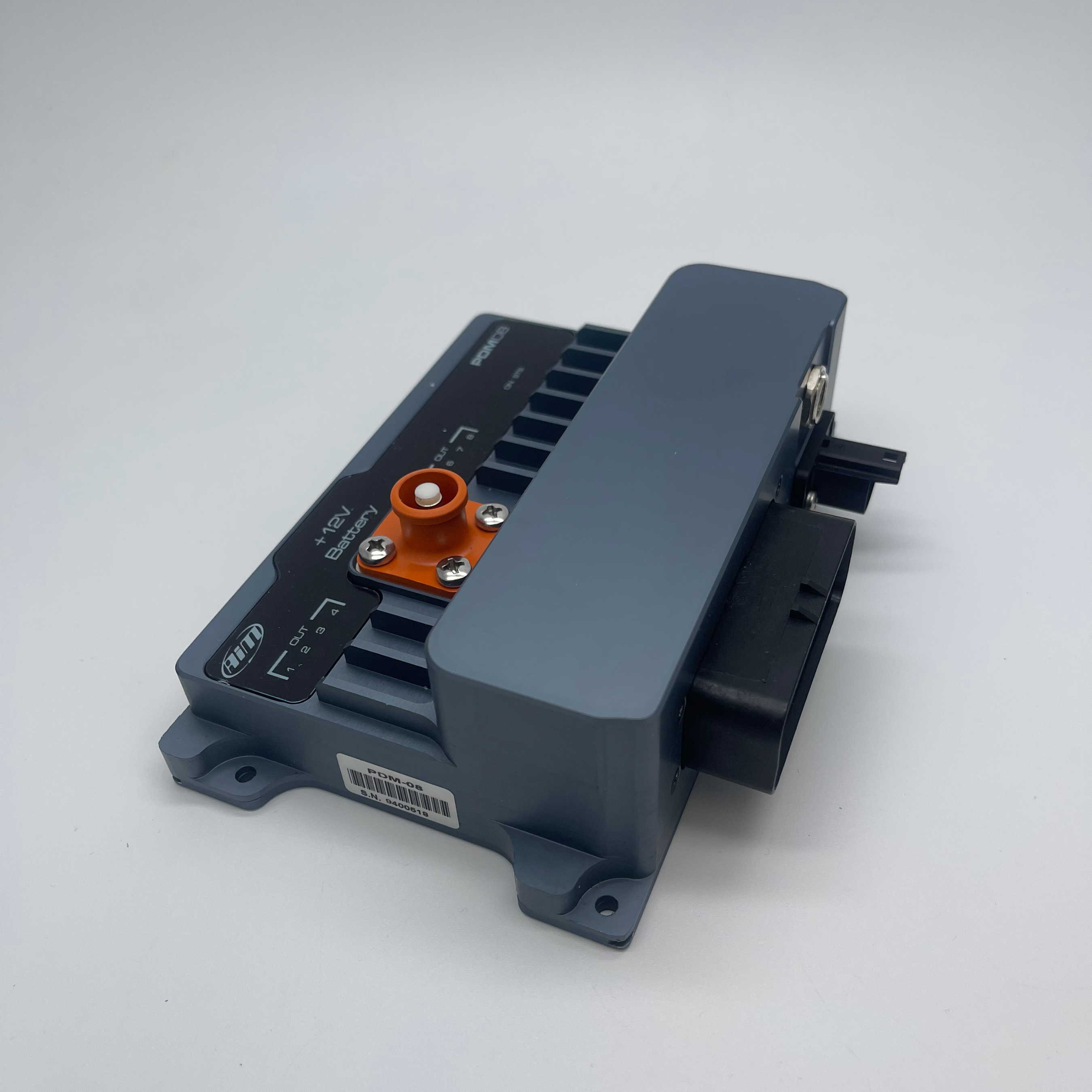

The Aim PDM08 is an 8-channel advanced power distribution module designed to power a multitude of vehicle circuits, removing the need for traditional fuse boxes and relays. It allows for a simplified wiring harness with increased reliability and control functions.

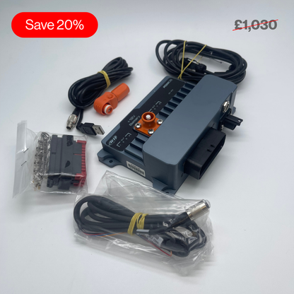

Optional Wiring Solutions
PDM08
SurLok Power Connector
Black 35-Pin Plug & Pins
CAN Expansion Cable
Download Cable

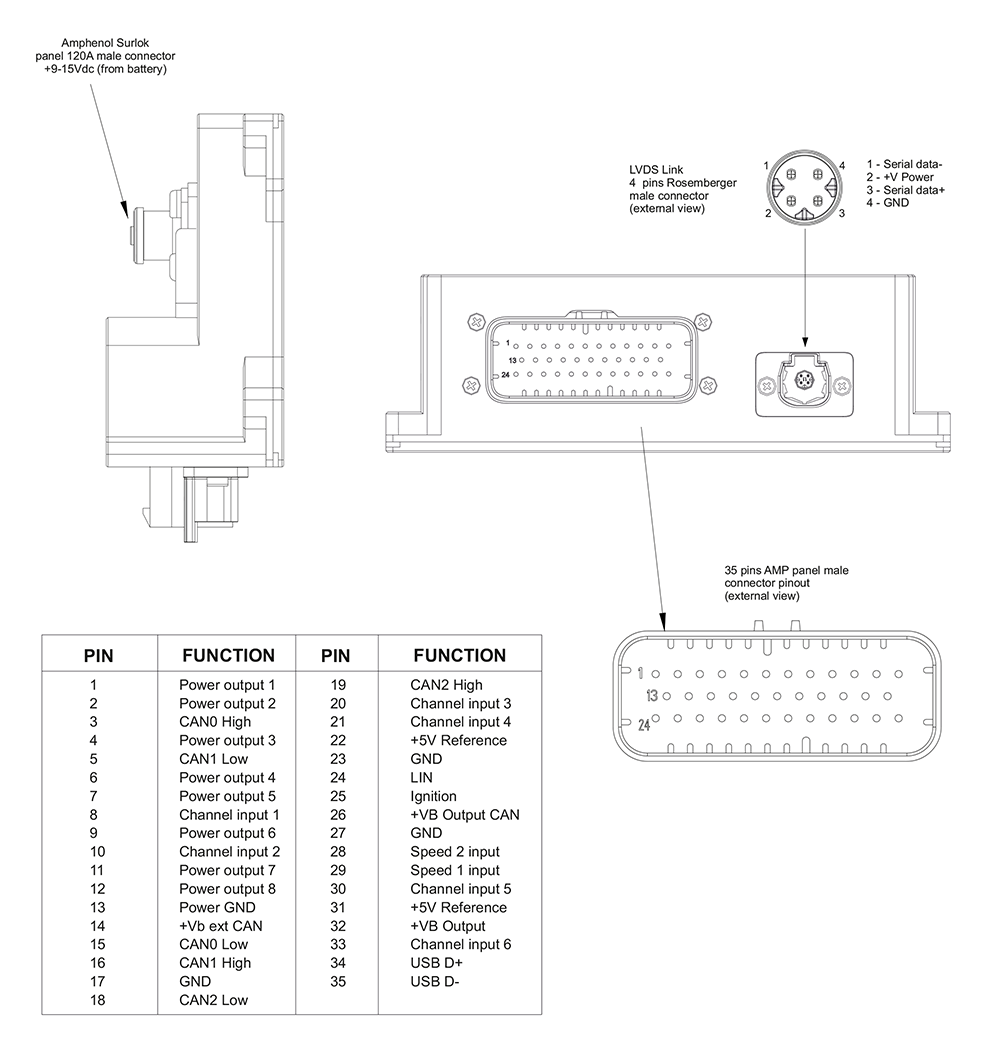

The PDM08 has 6 analogue or digital inputs and 2 speed. You can add a CAN Keyboard, giving between 4 and 15 buttons, wireless wheels giving up to 8 buttons and 2 rotary inputs, and RIO modules, which can give 8 high or low inputs and 11 low-only inputs.
