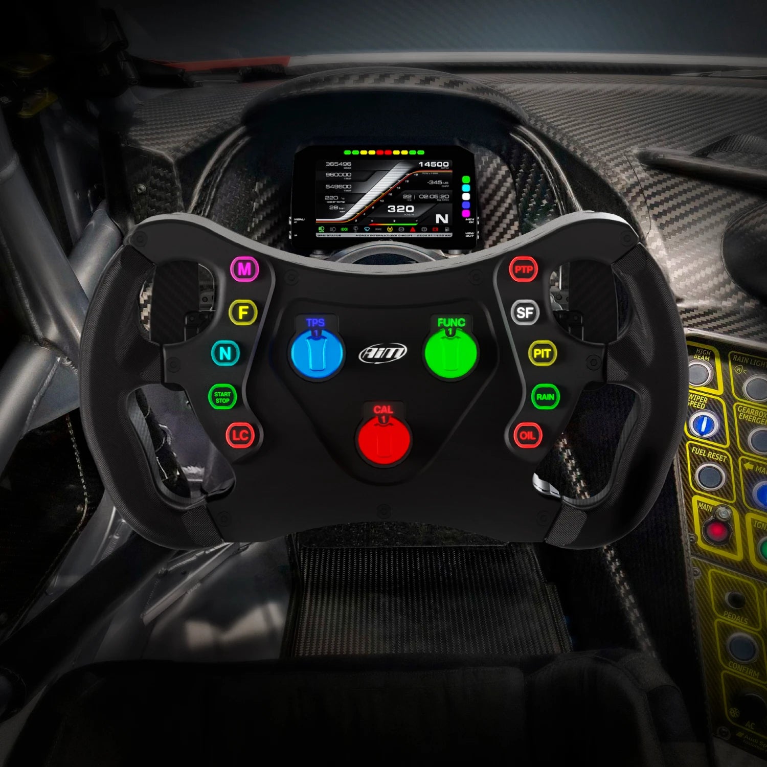

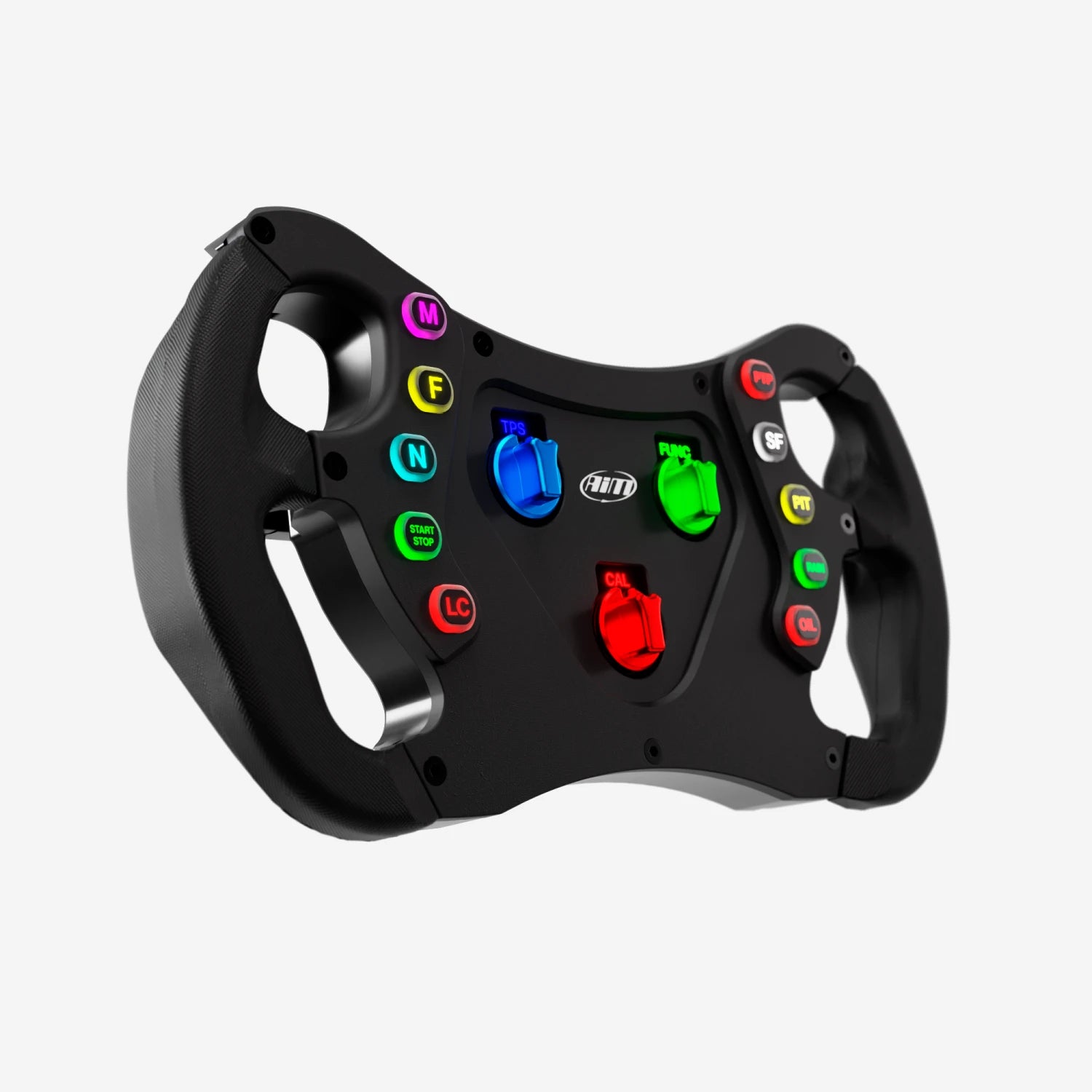

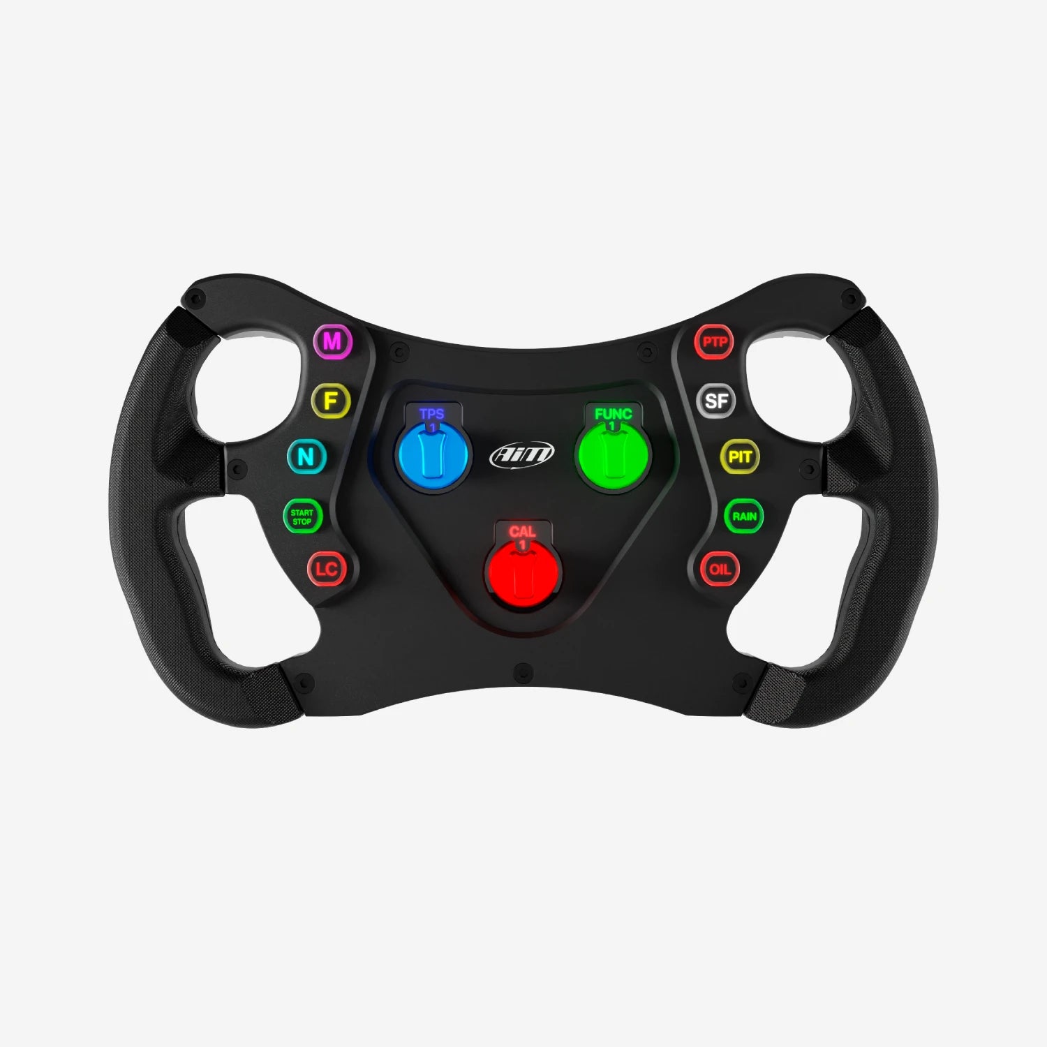

GT32 Electronic Steering Wheel
The GT32 Electronic Steering Wheel transmits the status of 8 push buttons and 3 rotary switches through a fully configurable CAN connection, plus 2 additional push buttons via free contact connections. It also supports 2 optional carbon fibre paddle shifters with a precise magnetic system for reliable, high-quality gear shifting.
