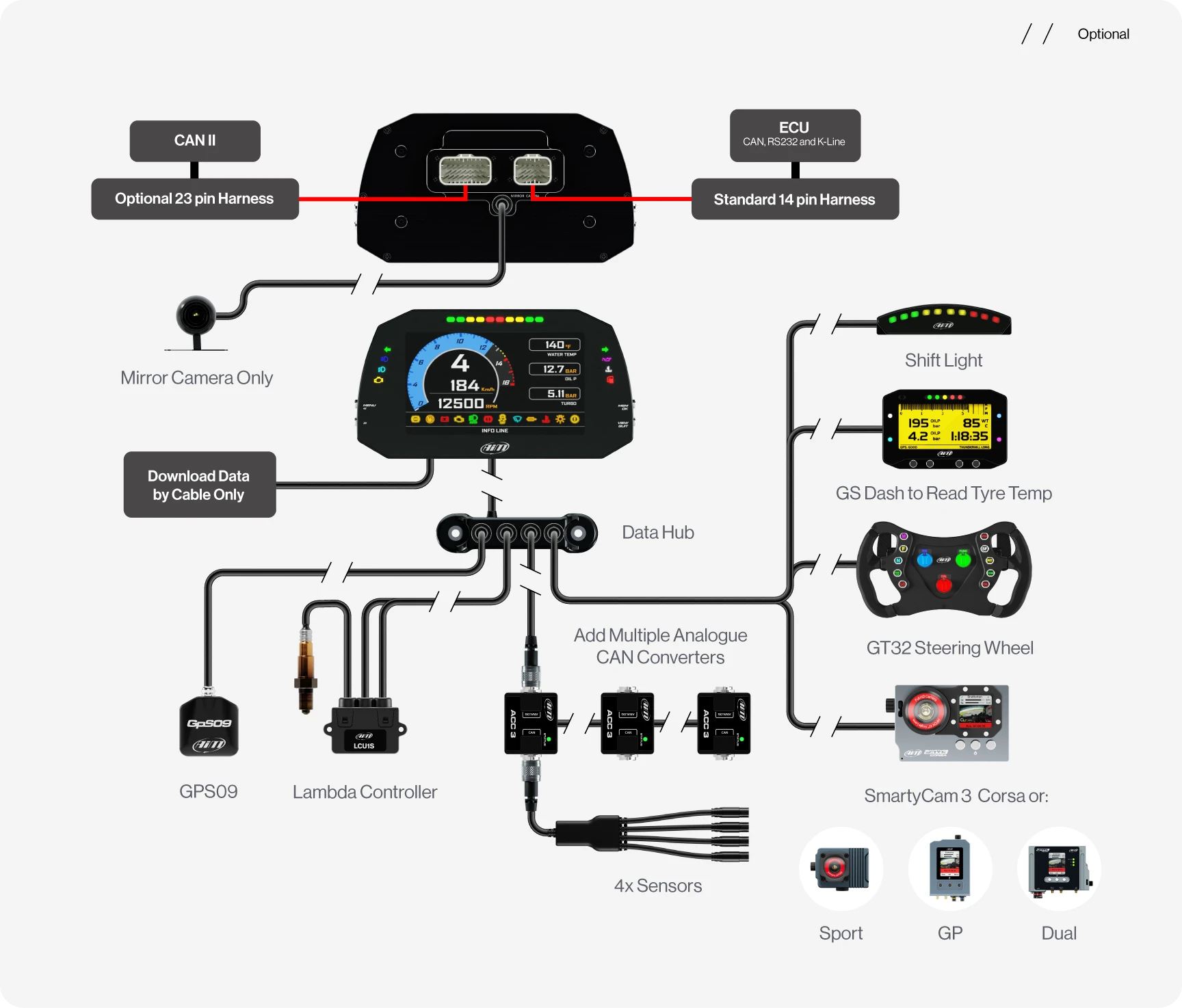

The MXG 1.3 Strada is available with a choice of connections. Choose either the OBDII or K-Line CAN, depending on whether you want to connect to the car's ECU or OBDII port or directly to the ECU through the CAN channel.
You can sample and display dozens of channels straight from the ECU with only 2 cable connections to the ECU instead of multiple connections to analogue sensors. The sampled data depends on the actual ECU, but will typically include RPM, throttle position (TPS), oil, air, water temperature, oil pressure, battery voltage, speed, gear, and lambda value (air/fuel ratio). The list of available ECU drivers is over 1,000 and is constantly being updated.

The MXG 1.3 Strada features a 1-AMP digital output configurable to be activated/deactivated depending on the value of the analogue/digital inputs or on the impulses coming from the car's ECU. This allows you to automatically run external systems, such as switching on/off additional lights, to activate/deactivate a cooling fan or circulation pumps when a certain event happens.
With CAN output, you can send messages directly to an existing CAN network to improve the range of car control possibilities.

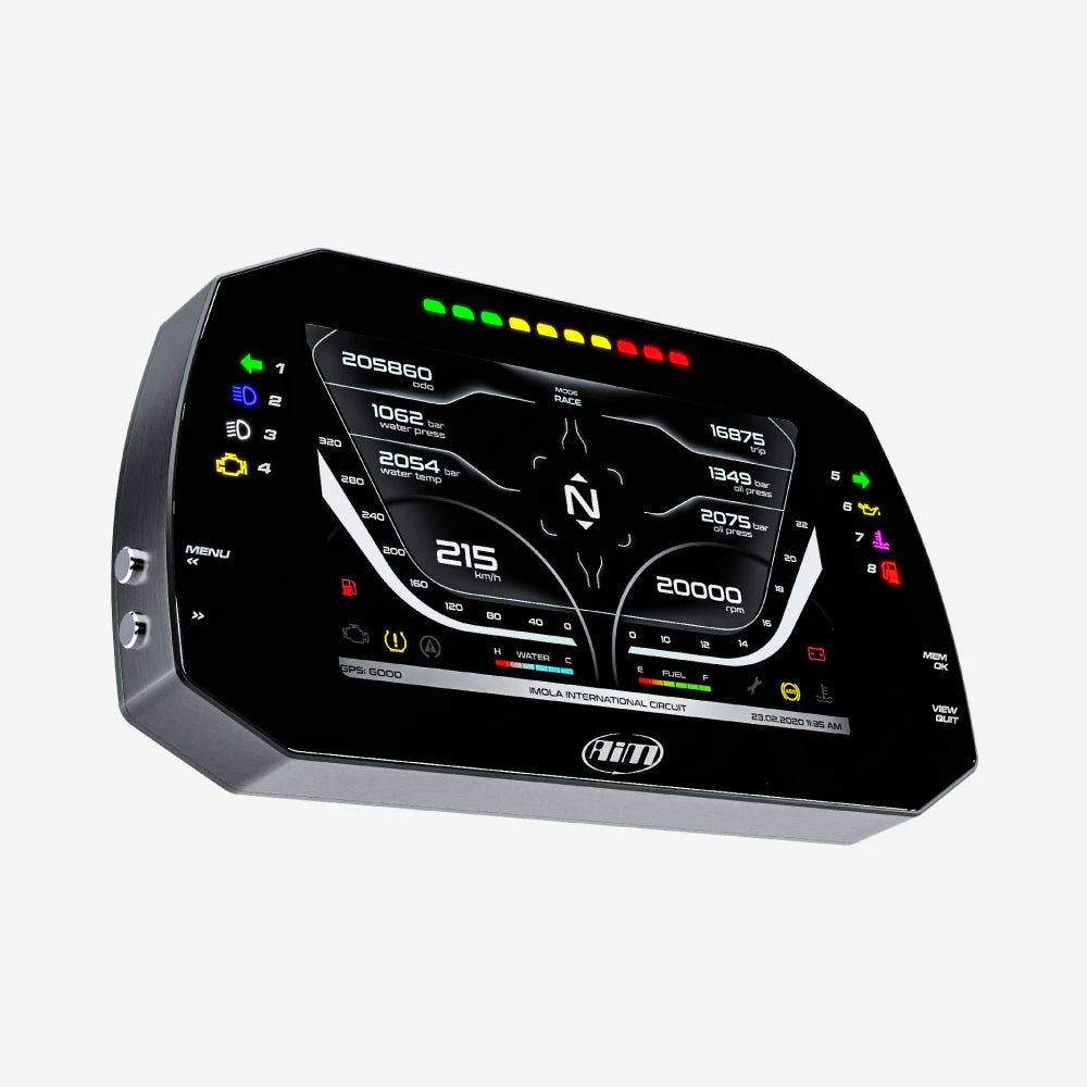

Display with Road Icons

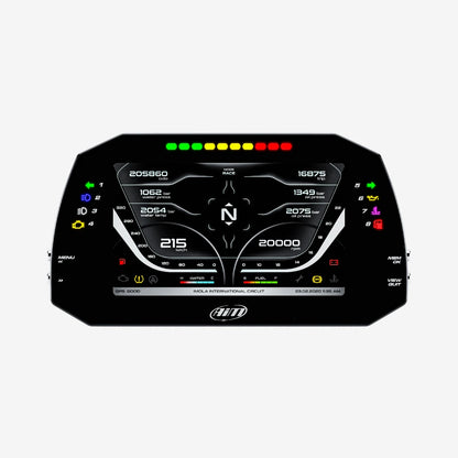

The MXG 1.3 Strada has a 7" TFT high contrast colour display. The visual quality is optimised by the ambient light sensor, which keeps the backlight at the best brightness levels.
Pre-Configured Pages
The MXG 1.3 Strada shows the RPM scale and all the data you need, like speed, water temperature and oil pressure, lap times and much more. You can customise pages to suit your requirements, including up to four additional fields. Define what data is shown with the end of scale and measure units. Swapping between the pages is easy; just use the push buttons.

14-Pin Standard Wiring

The Aim MXG Strada is a digital dash display that can be configured to show real time information from the car's ECU, analogue/digital inputs, predefined math channels and an optional GPS Module. It provides crucial information like speed, RPM, water temperature, and oil pressure on a high-contrast TFT screen.
What size is the MXG display?
The MXG features a 7", 800 x 480 pixel resolution display, making it one of the smallest displays in the MX Strada series.
What alarms can be set on the MXG Strada?
The MXG Strada comes with 8 customisable RGB LEDs, which are determined by inputs from the car's ECU or other sensors. The MXG Strada with road icons can be configured with alarms for direction lights, high beams, low beams, low fuel, low oil pressure and low oil level.
