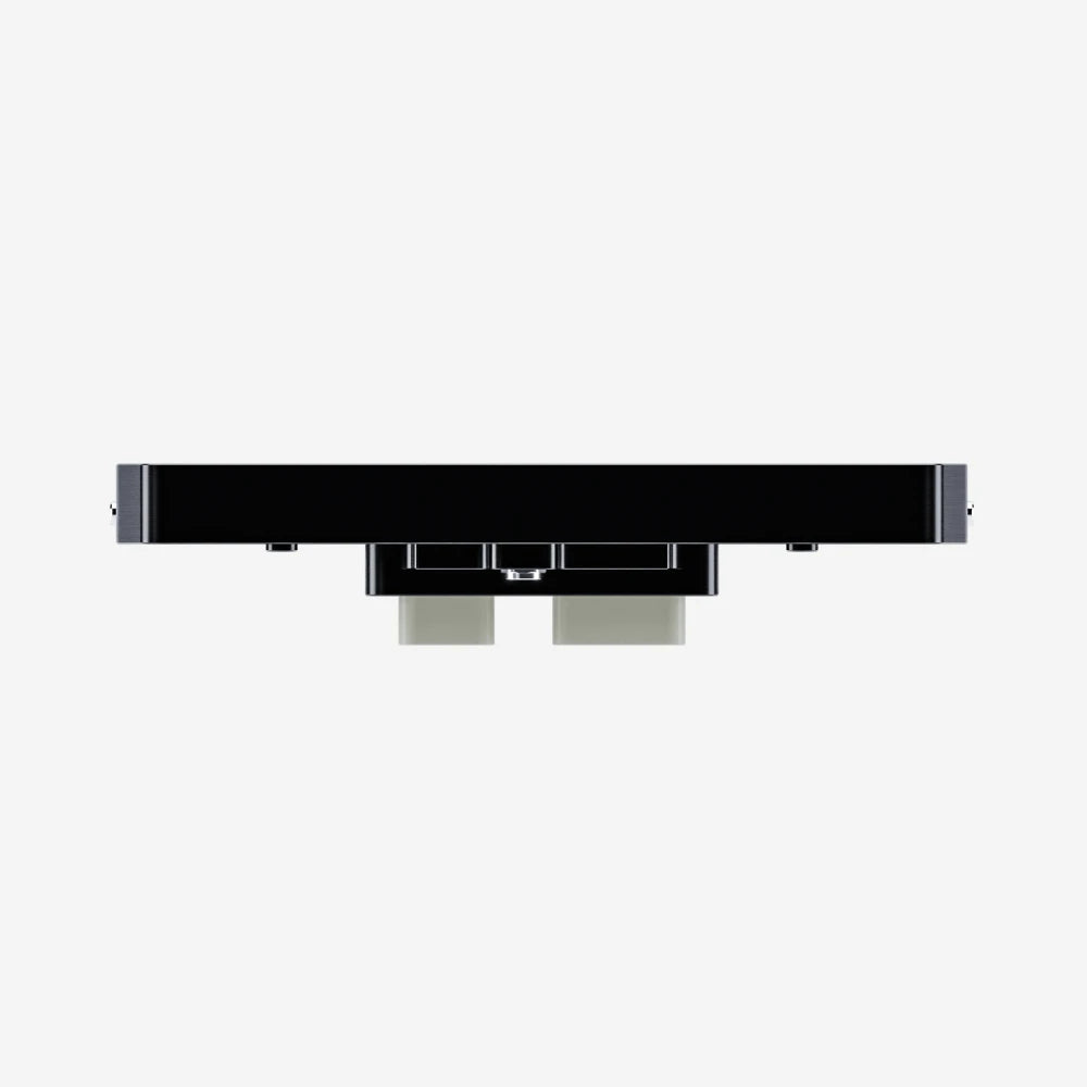

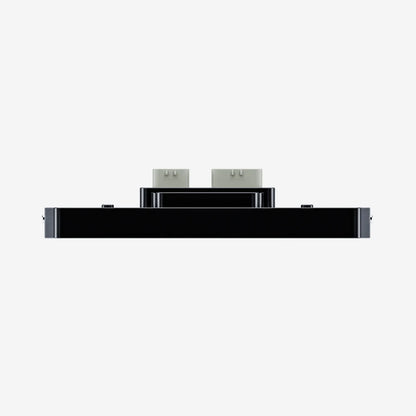

Advanced 10” Dash Display

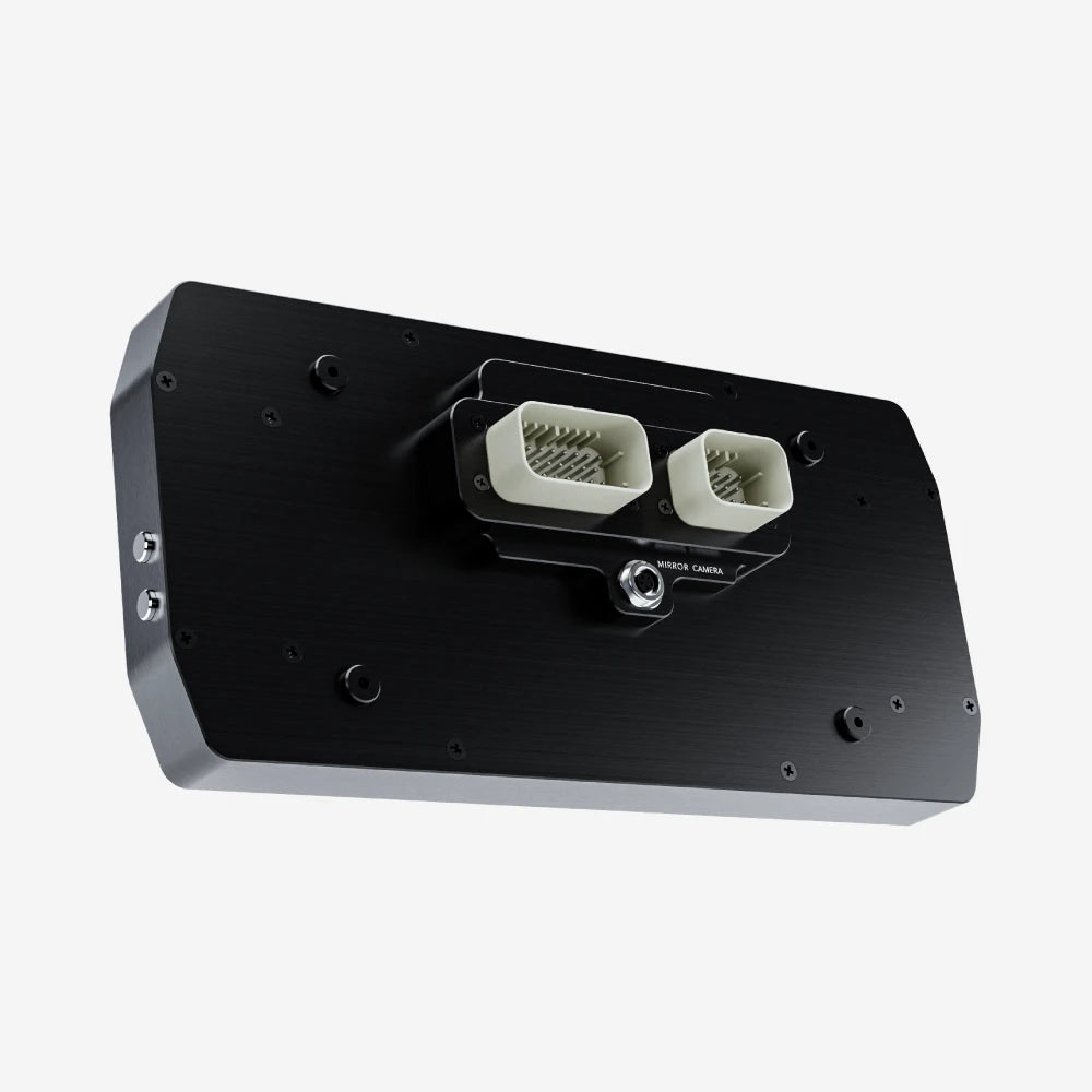

The MXT Strada with road icons is one of the most widely used dash displays on roads around the world. The MXT 1.3 Strada has a 10" colour TFT display that offers a great visual impact. You can configure the dash to show all the information coming from the ECU, analogue/digital inputs, predefined math channels and an optional GPS Module.
The MXT Strada 10 inch Display integrated into a car dashboard on a racetrack
Why Choose the MXT 1.3 Strada 10” Dash Display
The MXT Strada Display is an HD digital display, designed for motorsport drivers who need essential data visibility while on the track or road. The dashboard is tailored to show real time data such as speed, RPM and temperatures, but doesn't include data logging functionalities natively.
The MXT 1.3 Strada is available with a choice of connections. Choose either the OBDII or K-Line CAN, depending on whether you want to connect to the car's ECU or OBDII port or directly to the ECU through the CAN channel.
You can sample and display dozens of channels straight from the car’s ECU with only 2 cable connections to the ECU instead of multiple connections to analogue sensors. The sampled data depends on the actual ECU, but will typically include RPM, throttle position (TPS), oil, air, water temperature, oil pressure, battery voltage, speed, gear, and lambda value (air/fuel ratio). The list of available ECU drivers is over 1,000 and is constantly being updated.

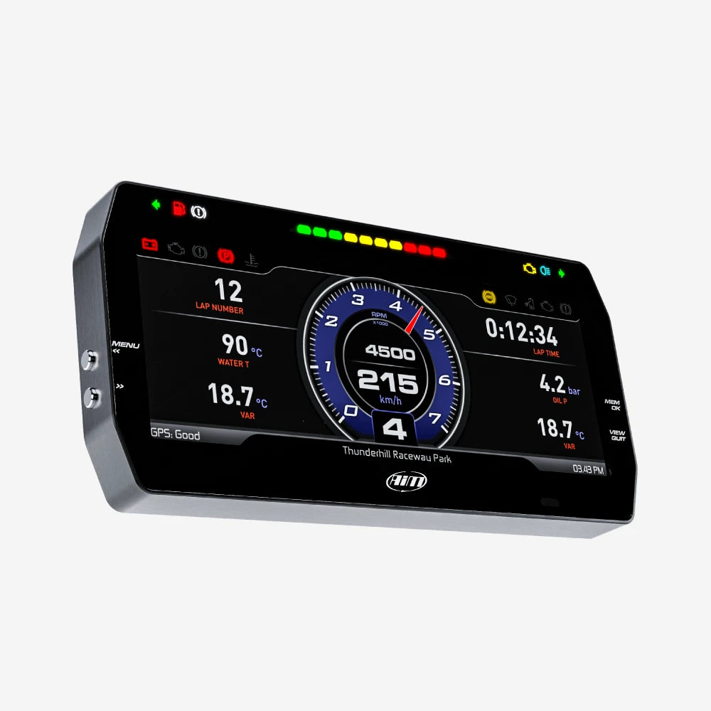

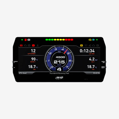

The MXT 1.3 Strada has a 10" TFT high contrast colour display. The visual quality is optimised by the ambient light sensor, which keeps the backlight at the best brightness levels.
Charger la vidéo: Pre-configured dash display screens for the MX Strada Series.
Pre-Configured Pages
The MXT 1.3 Strada shows the RPM scale and all the data you need, like speed, water temperature and oil pressure, lap times and much more. You can customise pages to suit your requirements, including up to four additional fields. Define what data is shown with the end of scale and measure units. Swapping between the pages is easy; just use the push buttons.
