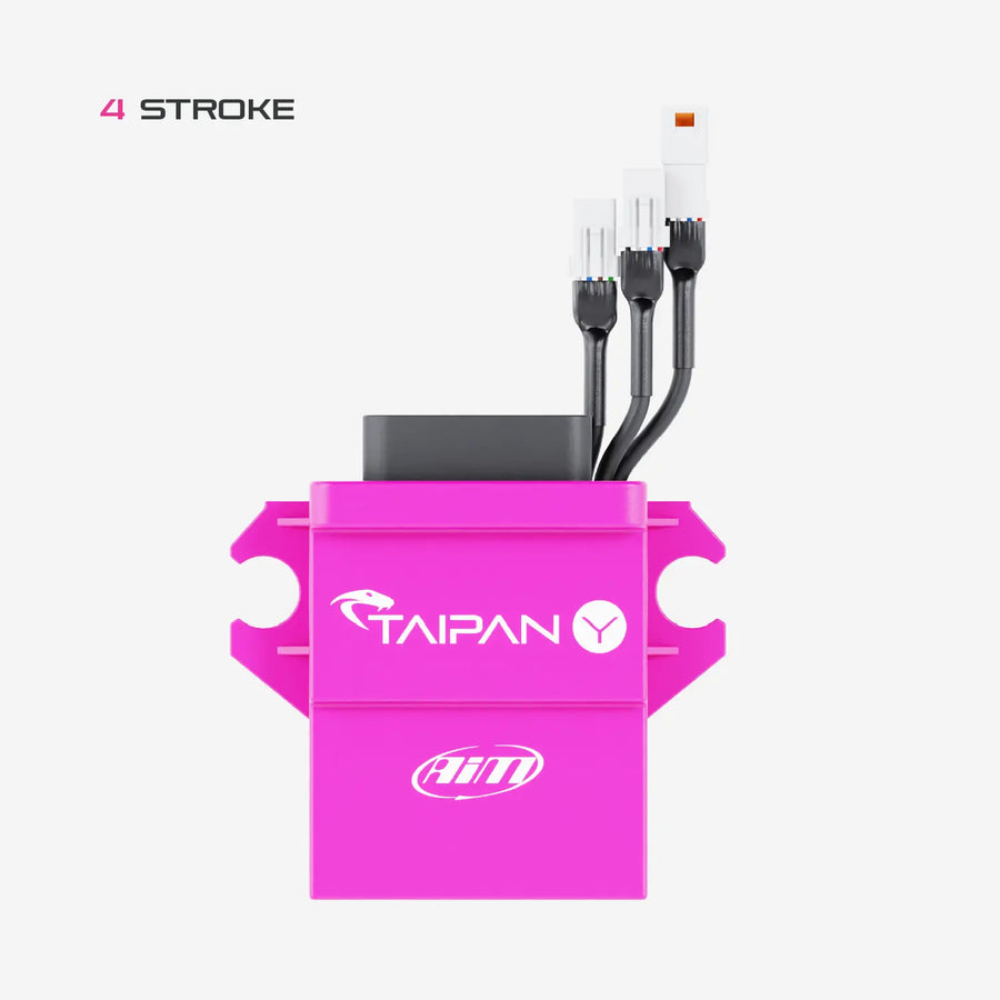

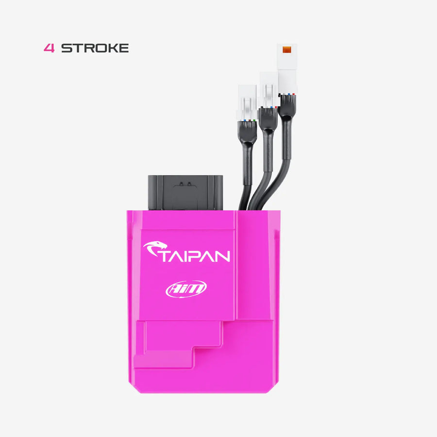

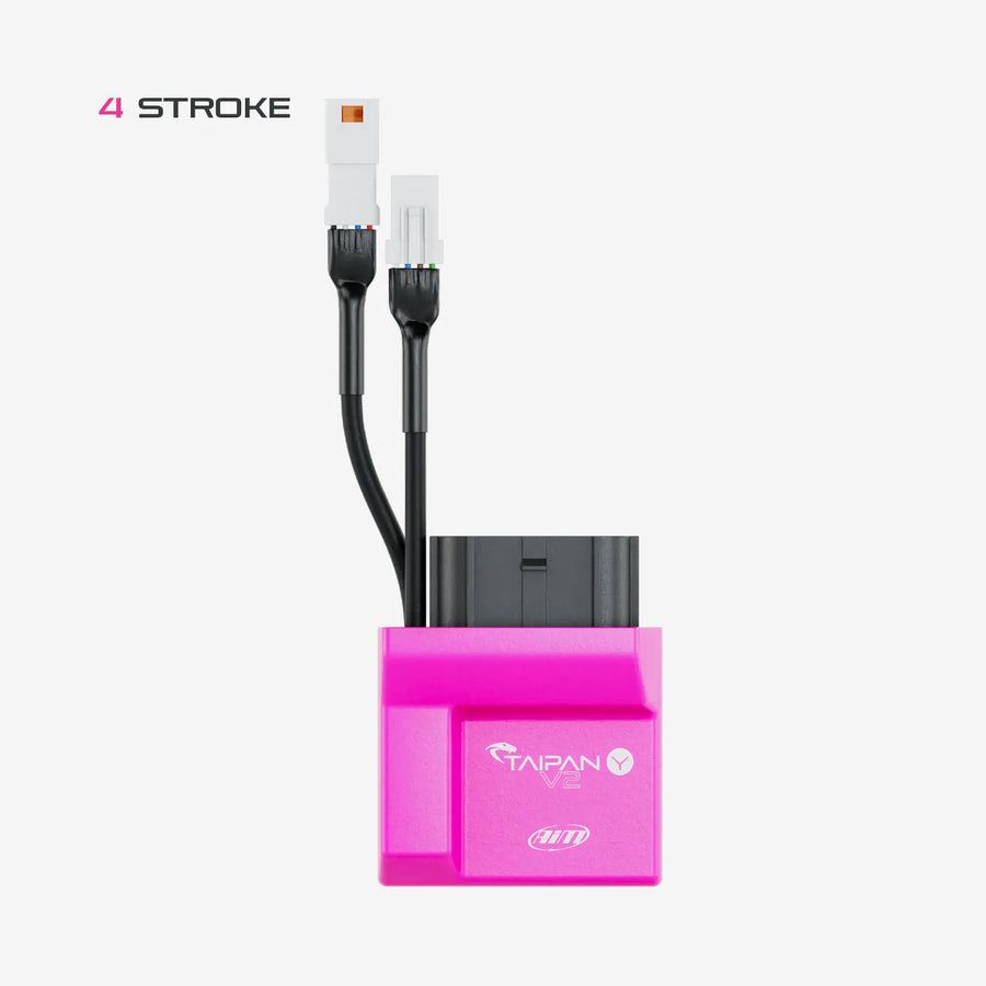

Taipan Y V2
Made For:
  • 4-Stroke MX Bikes
  • Ducati Desmo450 MX
  • GASGAS EC 250F/EC 350F/MC 250F/MC 450F
  • Honda CRF 250R/CRF 450R/CRF 450L/CRF 450R
  • Husqvarna FC 250/FC 350/FC 450/FE 250/FE 350/FE 450/FE 501/FE 450 Supermoto
  • Kawasaki KX250/KX450
  • KTM SX-F 250/SX-F 350/SX-F 450/EXC-F 250/EXC-F 350/EXC-F 450/EXC-F 500/SMR 50
  • Various Years From 2019 to 2025
Made For:
  • 2-Stroke MX Bikes
  • GASGAS MC 125/MC 250
  • Husqvarna TC 125/TC 250
  • KTM SX 125/SX 250
  • Years 2024 to 2025
Made For:
  • 4-Stroke MX Bikes
  • Yamaha YZ250F/YZ450F
  • Years 2019 to 2023
Made For:
  • 4-Stroke MX Bikes
  • Years 2023 to 2025
