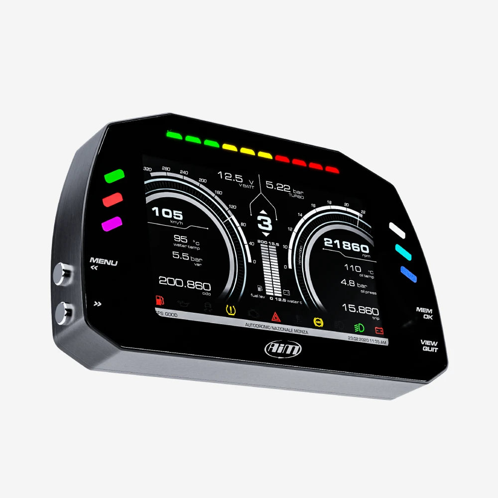

The Aim MXS 1.3 car dash display logger has a 5" TFT digital display, which has been designed to acquire and display data coming from the ECU. It is an ideal choice for racers who want valuable data at their fingertips but might be limited by space in the cockpit.
Note: MXS Strada & Strada Light options are also available with road icons to suit a variety of vehicle applications.
Why Choose the MXS 5" Car Dash Display & Data Logger

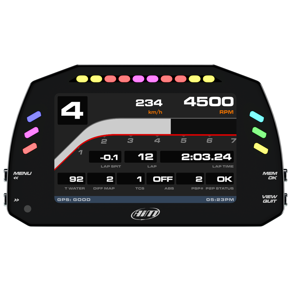

The Aim MXS 1.3 is a compact but powerful motorsport display and data logger. It offers real time data on its 5” TFT screen, has customisable display layouts, lap timing capabilities thanks to the GPS09 Module (included in the kit), and is compatible with a range of Aim devices and expansions for the ultimate setup.

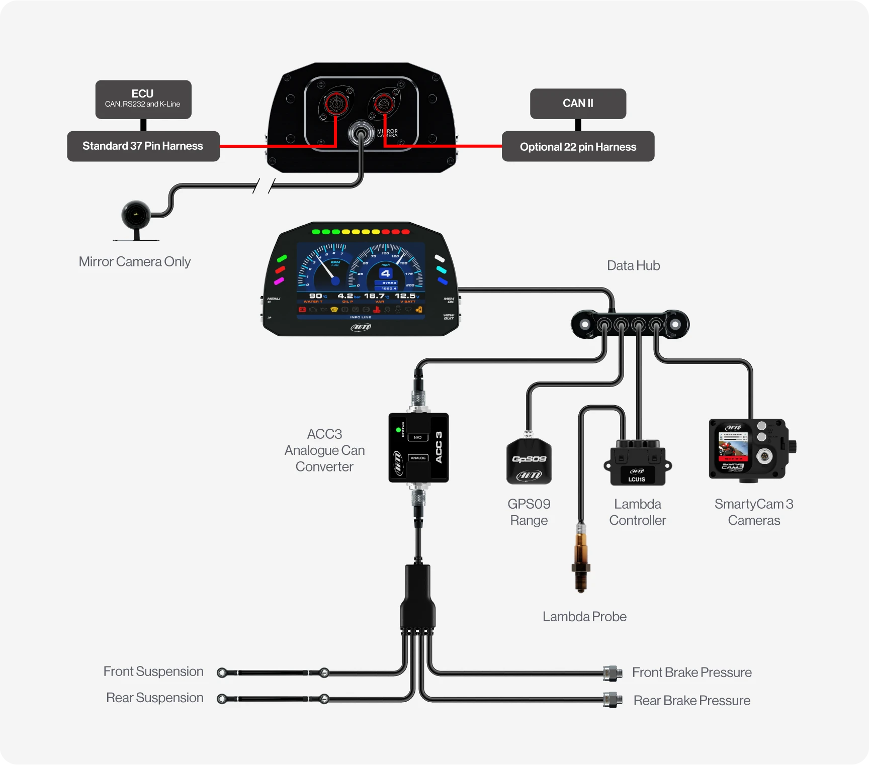

Connecting the MXS 1.3 dash to the ECU is simple. You can sample dozens of channels straight from the car's ECU (compatible with over 1,000 different ECUs), requiring only a cable connection to the ECU instead of multiple connections and analogue sensors.
Configurable Pages

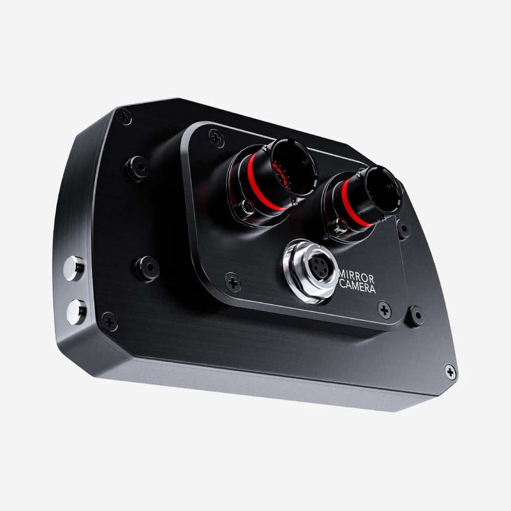

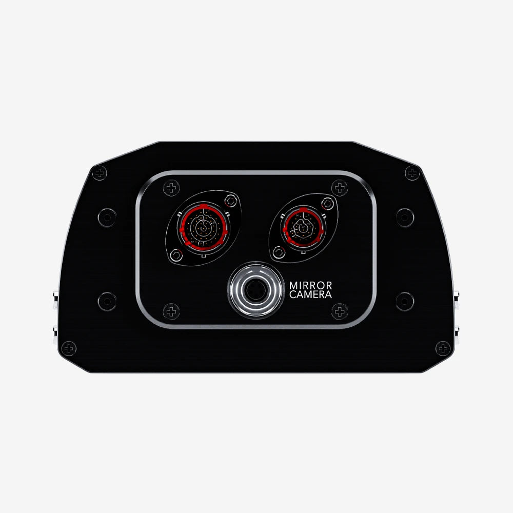

Two analogue camera inputs are available to switch your display into a mirror camera, activated by a push button or event. The camera is sold separately.

The GPS module, connected to the MXS dash logger via CAN, simplifies lap time calculation and track position analysis. With over 4,000 tracks worldwide already stored, including the start and finish line coordinates, you’ll have no trouble monitoring your position and lap times when you’re on the track.
As soon as the MXS is turned on, the GPS module will locate its position, identify track line coordinates and start immediately sampling lap and split time. If the track is not in the database, you can easily add the start/finish line coordinates to the MXS using our Race Studio 3 software.

The SmartyCam camera series also connects to record synchronised video and telemetry ready for analysis in Race Studio 3.

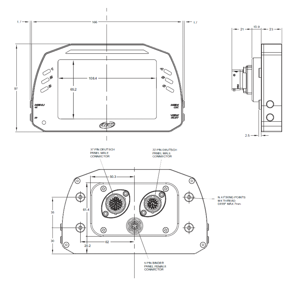

What size is the MXS Dash Display Logger?
The MXS features a 5", 800 x 480 pixel resolution display, making it one of the smallest displays in the MX Logger Series.
What alarms can be set on the MXS Display Logger?
The MXS Display Logger comes with 6 customisable RGB LEDs, which are determined by inputs from the car's ECU or other sensors. The MXS Dash Display Logger can be configured with alarms for gear position, lap time improvement, throttle position, low fuel, low oil pressure, low oil level and other customised alarms that have been set.
