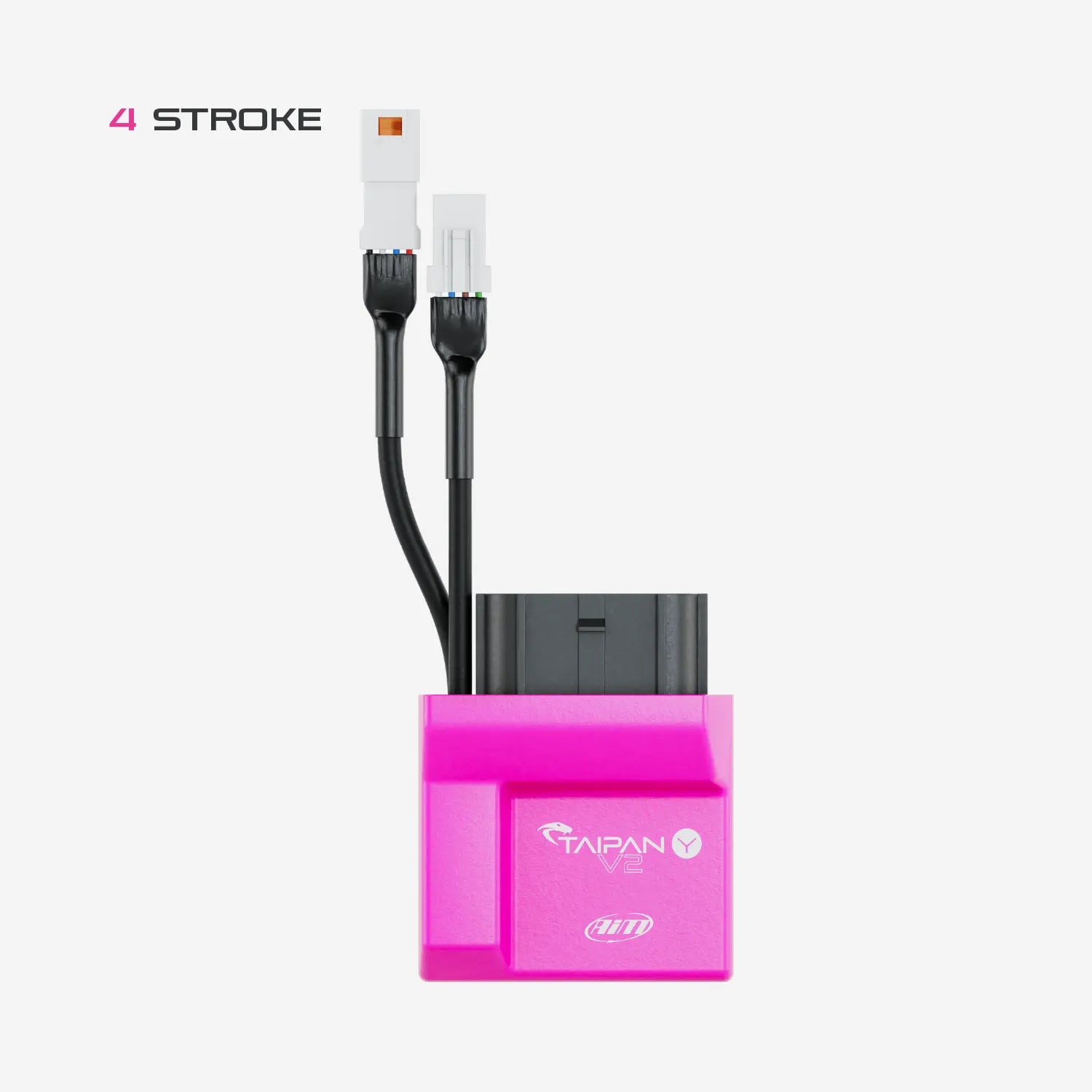

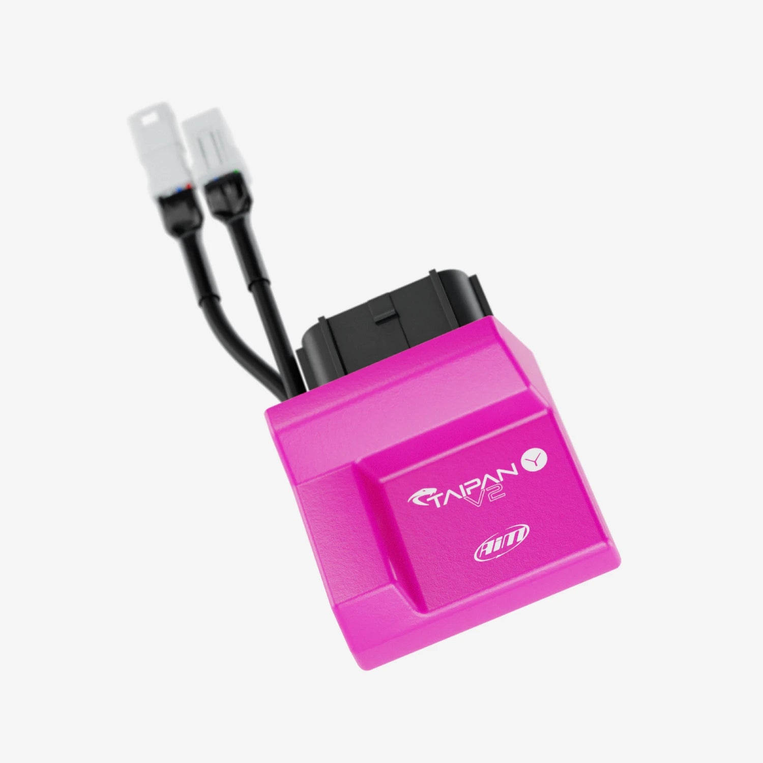

Aim Taipan Y V2 ECU
Aim Taipan Y is compatible with Yamaha motocross bikes
The Taipan Y V2 ECU is an aftermarket plug & play engine control unit created by Aim, exclusively designed for plug & play installation with Yamaha YZ250F and YZ450F motocross bikes (2024-2025).
Why Choose the Taipan Y V2 ECU
Thanks to its high-technology 32-bit core, the Taipan Y V2 ECU represents an important step forward to improve the performance of your motocross bike, without sacrificing reliability and smoothness.
Engine control requires precision. At 20,000 RPM, the Taipan Y V2 ECU guarantees precision of 1/10 of a degree: this means an accuracy within 0.8 microseconds (µs) for turning the spark ON.
This precision is the key to guarantee:
  • A very consistent engine rotation.
  • The possibility of repeating dozens of tests at the bench, always obtaining the same result.
  • A perfect reactivity at every minimum change of any point of a map, resulting in more power at the wheel.

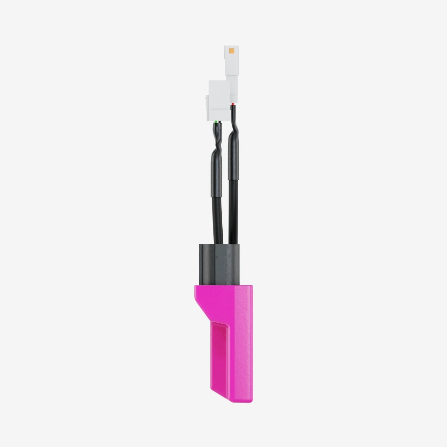

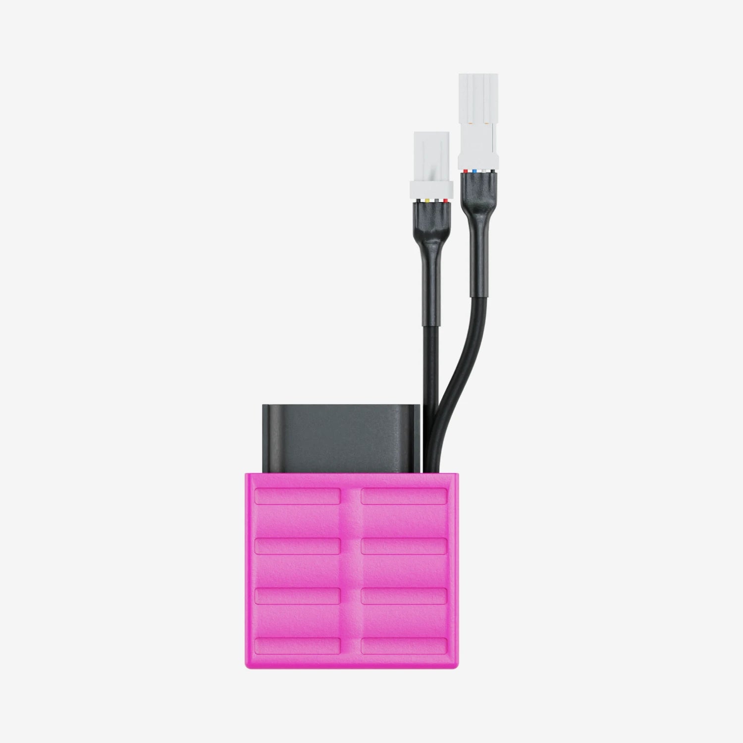

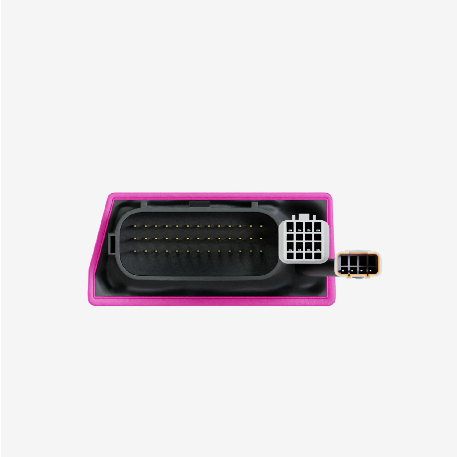

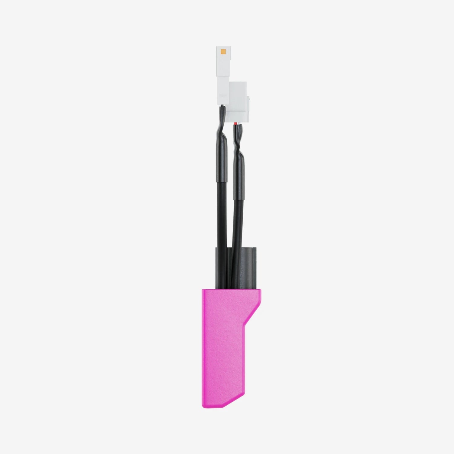

Taipan Y V2 ECU Connections
The Taipan Y V2 ECU has 4 connectors:
  • Main Connector: Compatible with most off-road bikes.
  • CAN Connector: Connects to the Handlebar Switch 2 and data logger.
  • 2nd CAN Connector: Connects to the UC Bridge to communicate with the PC.
  • 3rd Connector: Connects to spare analogue inputs and a possible second injector.

  • Two 0-5V analogue inputs sampled at 1,000Hz each - could be alternatively used as a switch to ground
  • One low-side driver (1A)
  • Two CAN bus - one for calibration purposes, one for expansions (Aim Handlebar Switches, data loggers, dashes etc)
  • Two JST JWPF waterproof auxiliary connectors
  • Power Consumption: 150mA

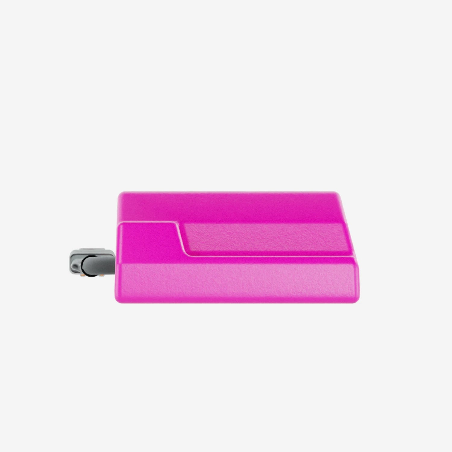

  • Body: PA6 + 30% glass fiber
Connectors
  • 1 JST 04T-JWPF-VSLE-S connector
  • 1 JST 08R-JWPF-VSLE-D connector
  • 1 33-pin male connector
  • Dimensions: 64.5 x 59 x 29.5mm
  • Weight: 150g
  • IP67
SKU: C-ECU-KIT-YAM
Part Number: XE1ECUTYV2
