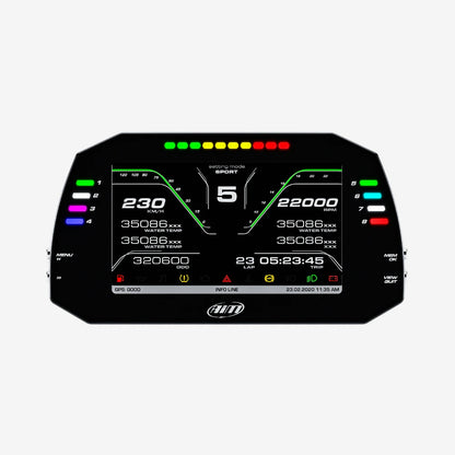

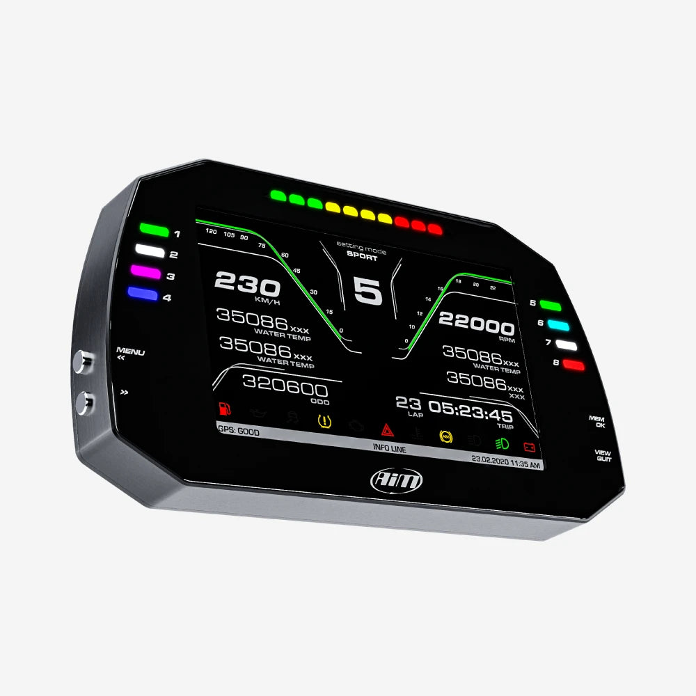

Advanced Powerboat Dash Logger
The MXG 1.3 powerboat dash logger has a 7" TFT digital display, which has been designed to acquire and display data coming from the ECU. It is an ideal choice for sailors who want valuable data at their fingertips.

The MXG display logger also comes with 8 RGB LEDs, allowing you to customise colours, alarm types (solid or flashing), flashing frequency and accompanying text messages. Alarm priorities can be set to suit your specific requirements.
Cargar video: Pre-configured dash display screens for the MX Logger Series.
Pre-Configured Pages
With its high-contrast 7” TFT display, you can configure pages to suit your needs. The digital display also allows you to easily navigate through the pages to choose from a variety of styles, data types and measurement units. An ambient light sensor adjusts the backlight for optimal brightness, ensuring clear visibility in all lighting conditions.
