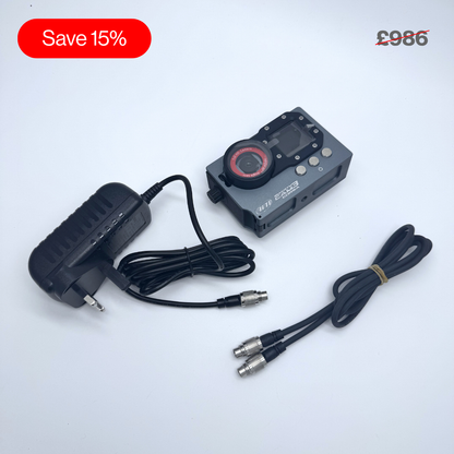

This SmartyCam 3 Corsa is fully equipped and ready to take on its second life. The product is in full working order at a reduced price, and has been meticulously checked by our technicians.
The Best Motorsport Action Camera
The Aim SmartyCam 3 Corsa camera has been engineered to deliver unparalleled video performance, with GPS and ECU data for complete and comprehensive information, making it one of the best motorsport action cameras on the market.
Please Note:  The camera MUST be externally powered as the internal battery is only designed for initial configuration.
