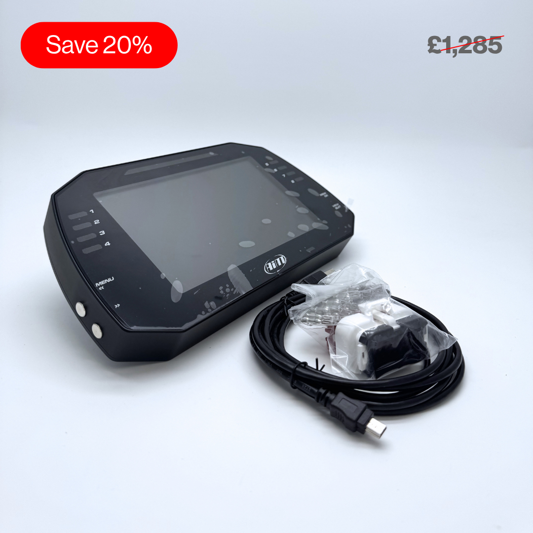

This MXG Strada is fully equipped and ready to take on its second life. The product is in full working order at a reduced price, and has been meticulously checked by our technicians.
