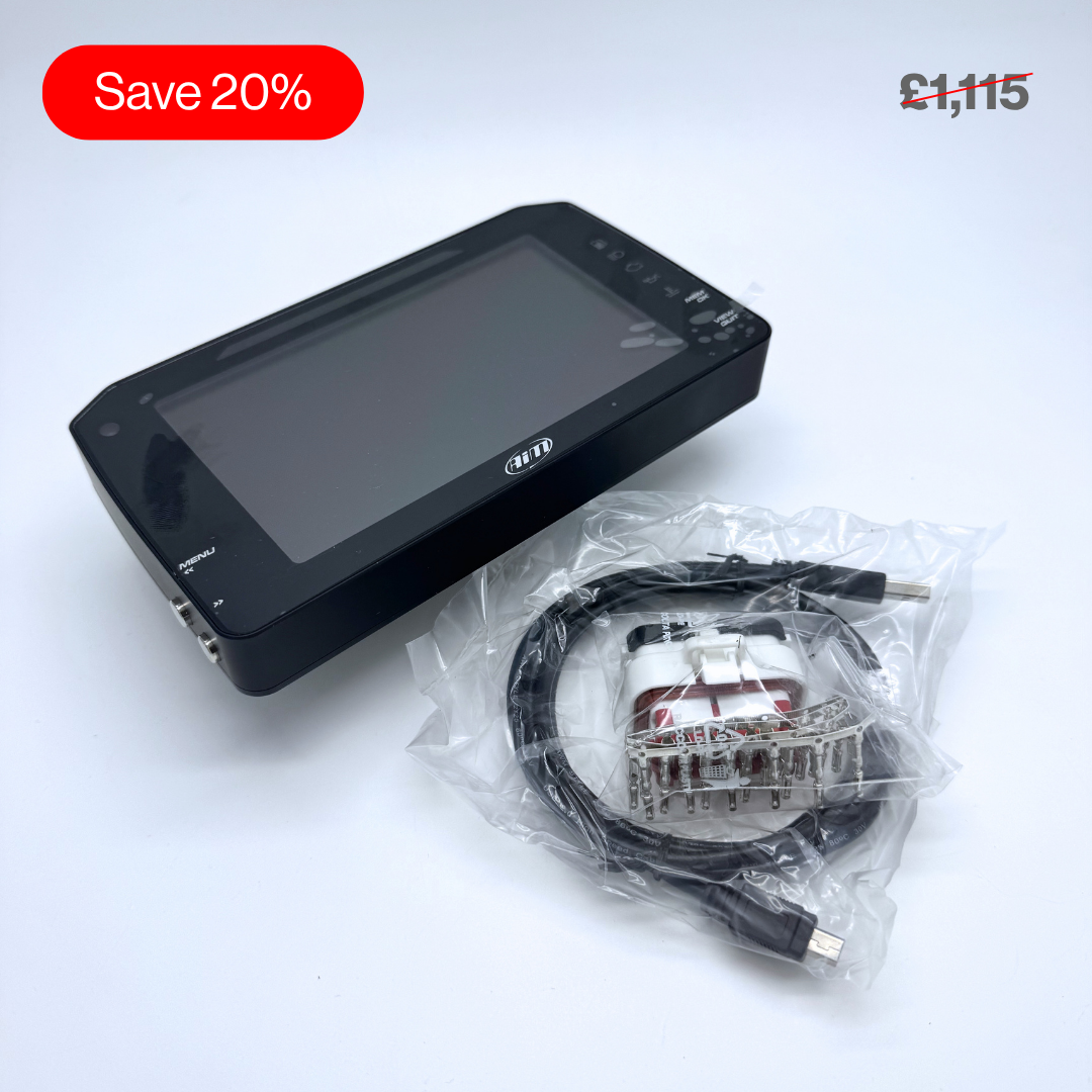

This MXP Strada 6" Display is fully equipped and ready to take on its second life. The product is in full working order at a reduced price, and has been meticulously checked by our technicians.
Compact 6” Dash Display
The MXP Strada with road icons is one of the most widely used dash displays on roads around the world. The MXP 1.3 Strada has a 6" colour TFT display that offers a great visual impact. You can configure the dash to show all the information coming from the car's ECU, analogue/digital inputs, predefined math channels and an optional GPS Module.

The MXP Strada Display is an HD digital display, designed for motorsport drivers who need essential data visibility while on the track or road. The dashboard is tailored to show real time data such as speed, RPM and temperatures, but doesn't include data logging functionalities natively.
The MXP 1.3 Strada is available with a choice of connections. Choose either the OBDII or K-Line CAN, depending on whether you want to connect to the car's ECU or OBDII port or directly to the ECU through the CAN channel.
